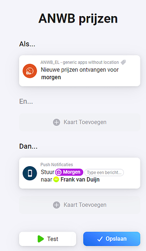

Hi there,
thanks for all the effort you have put in to this.
this is maybe a noob question, but how can i send the graph of the new prices for tomorrow to my phone.
i have this flow set up.
The Graph is still usefull, either way. was just hoping to send it as a popup to my phone.
i like that this way it shows me the actual costs per kwh.
Athom (@meerlol ) is working on solving the issue with images. So have patience :sunglasses:
