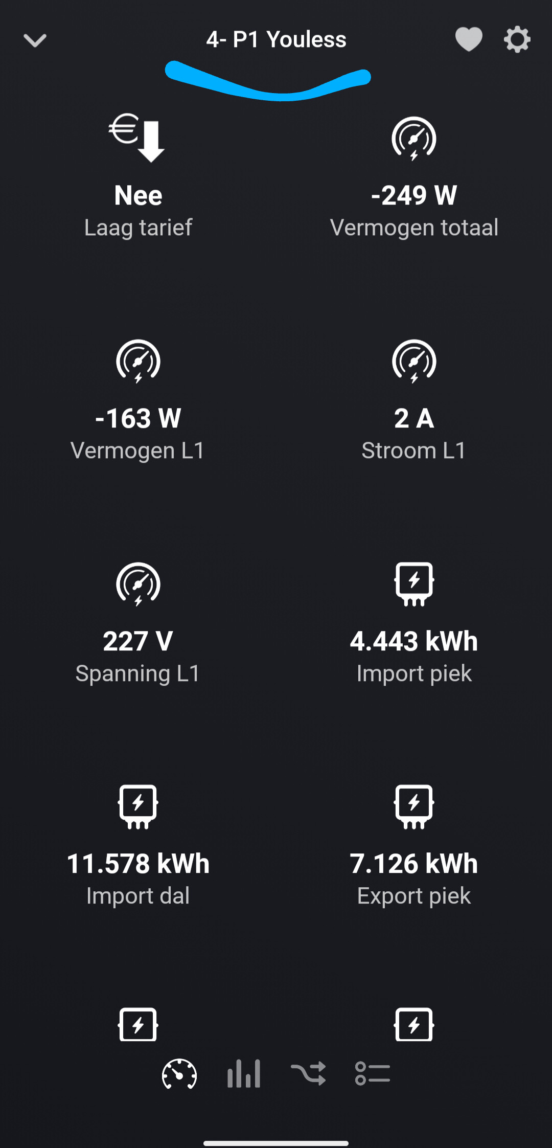

I have my new smart meters installed and my Youless P1 meter shows data is received in Homey:
So far so good.

The smart meter was replaced, so the P1 cable detached, new meter installed, P1 cable clicked in again. The native Youless application (so, not Homey) shows data:
And so does the Youless device in Homey:

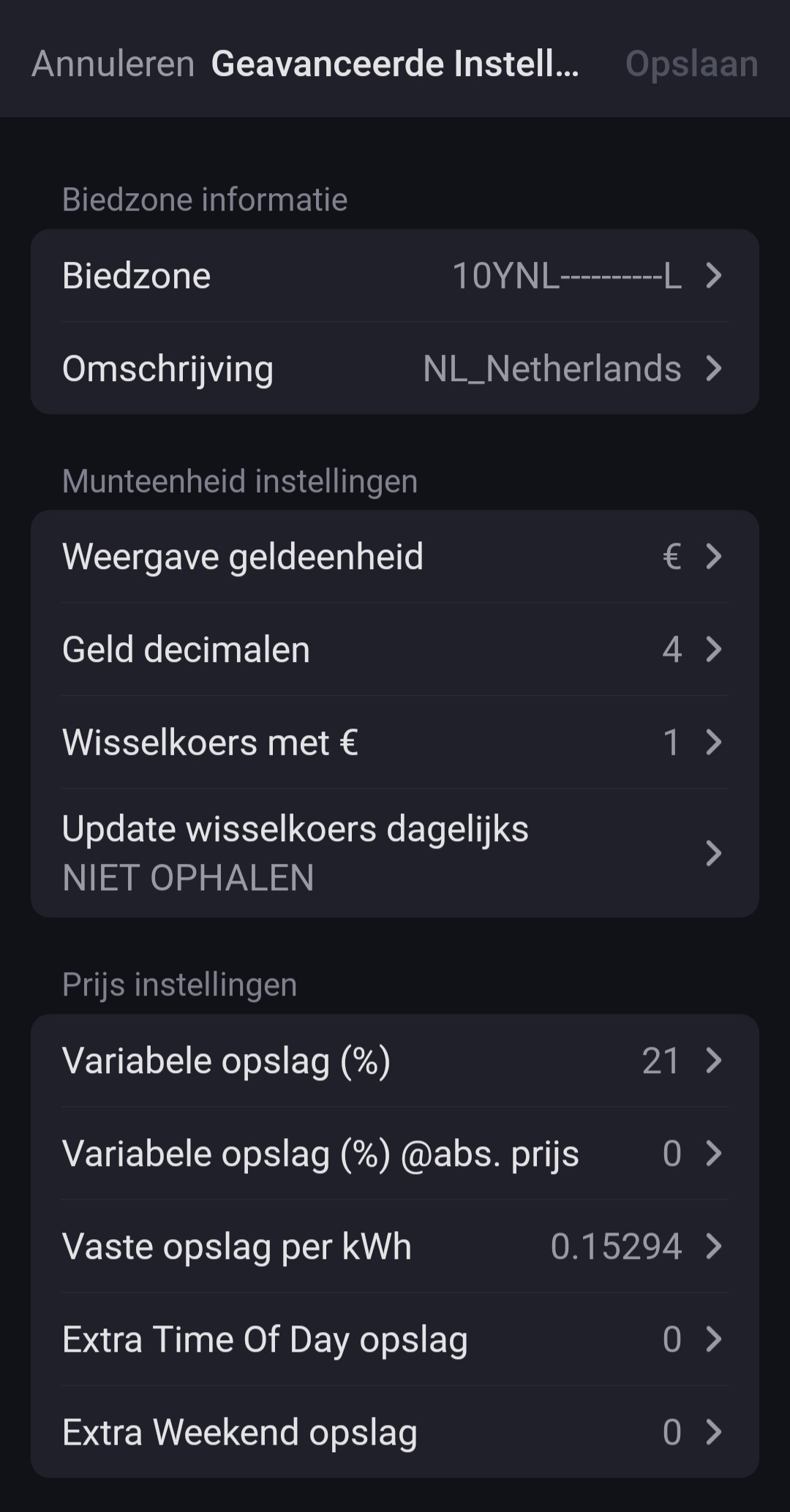

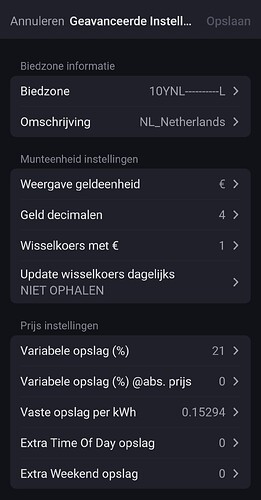

I just remembered that I had not updated some markup values for a PBTH electricity prices device, but when I try to change any settings, I just get a red warning saying “device is not ready. Ignoring new settings!”.
If I add a new electricity price device and try to make changes to its settings, it seems to instead give me the “Timeout after 10000ms” error.
I’ve tried restarting the PBTH app, no effect. I’m not seeing the same issue if I try to change settings in other devices. I have a couple of PBTH power summarizer devices too, and I can change settings for these without problems, so it seems to only affect the electricity prices devices I have.
