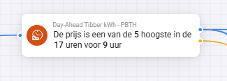

I have a question about the card “The price is one of the X highest in the Y hours before Z”. I hope I translated it correctly from Dutch “De prijs is één van de X hoogste in de Y uren voor Z uur”.
I use this card to discharge my solar filled home battery on the most expensive hours during the night. But someting strange happens.
The flow where this card is used is activated at 16:00 hours each afternoon. I use the following parameters:
Yesterday after 16:00 hours (and before 9:00 this morning) there were two different price peaks. One around 18:00-20:00 yesterday evening and one around 7:00-9:00 this morning.
So, what I expect is the the Battery will discharge on two different moments, but what happened is the following:
One flat line from 100% capacity to 0%.
It looks like the card doesn’t know about the second price peak the next morning. I’ve witnessed this behavior a couple of times now the last week. I’m not sure if it worked correct before.
Could this be related to the correct prices issue mentioned in the last couple of posts in this topic?
Or do I interpretate the PBTH card incorrect?
@Gruijter At the moment there seem to be no prices for tomorrow available in the app. Can this have something todo with the switchover to quarterly-prices pet 1-oct?
