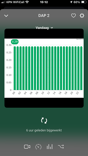

Something strange happened half an hour ago. Not exactly on the hour, but a few minutes after. All prices for today were changed to 0.30. The prices for tomorrow have been received an hour ago, so I’m not sure what could have caused this. Anyone else? Rebooting the app did not solve this.
Confirmed
All E prices are 29,17 cent
AFK now
DAP for The Netherlands is not adjusted since the last 6 hours.
Same here. In Finland showing 0,0117€ for the whole day and thanks to this, my heating is set to full. It’s just that in Finland this is actually one of the most expensive days in January so this is a very unfortunate timing for the app to break :cold_sweat:
It would be really nice if, instead of showing ‘false’ data if there is an API error, the app would actually report an error back as well, so we can take action (eg disabling specific flows)… any way to implement that in a future version, @Gruijter ?

Luckily I was manually adjusting the discharge power of my Sessy battery to full power (because of the high price at 17:00) and saw the battery was actually charging (because of the incorrect low price) :scream:
Unfortunate moment, but let’s not blame @Gruijter , we’re using this app “at own risk”.
It is working again since half an hour ago.
The Entso-e transparency platform seems to have a problem with all EU prices. Nothing PBTH (or I) can do but wait…:saluting_face:
