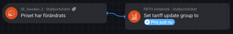

I have some trouble to update the price tariff with PBTH. I have tried it many ways but this is the most recent way I have tried it with:
“Priset har förändrats” = “Price has changed” and then I try to update the price on my PBTH statistic with “Set tariff update group to “#Price right now””. I can manually change it under settings for my PBTH but not with a flow that updates the PBTH with the current price.
What am I doing wrong?
