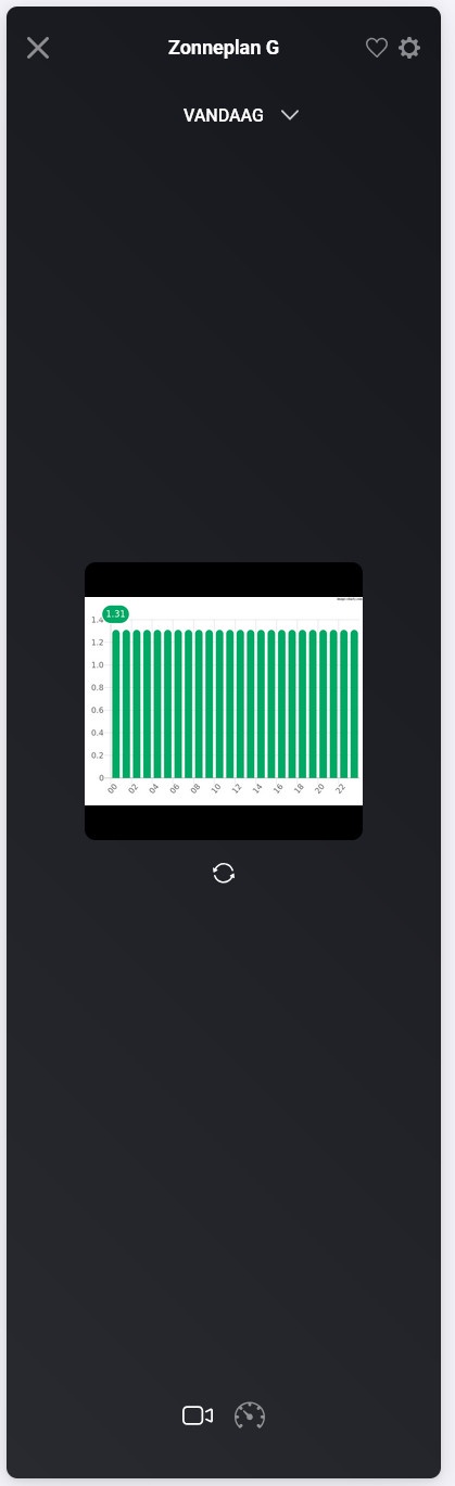

This graphic of today is wrong for the 00:00 - 05:00 part.
Hi Theo, thx for all the input. I see there is a problem with gas prices. But so many apps, so little time. Since the gasprice bug impact is limited, it is not top of my list. Be (very?) patient :wink:

The gas JSON file for “today” and “tomrrow” are right now.
Thanks @Gruijter :+1:
Thx! But the issue cannot be gone since I didnt change anything :wink:
LOL :joy:
This morning I try to make a little adjustment to the FM price for today and that was not working.
Even the graphic in the virtual device was gone.
Therefore I reset the app but with no result.
Later I get my flow messages that the new gas price for tomorrow was there.
Looking to the JSON file of “tomorrow” I saw the old and the new price.
But also in the JSON file of “today”.
Then I was thinking ‘it’s repaired’. :wink:
The 2nd time to adjust FM price it was direct accepted and good.
Is this now not also an error? :thinking:
