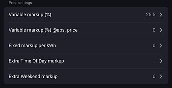

I’m new to pbth so I might missed something, but it seems that the app doesn’t fetch the correct prices for the Finnish market at least.

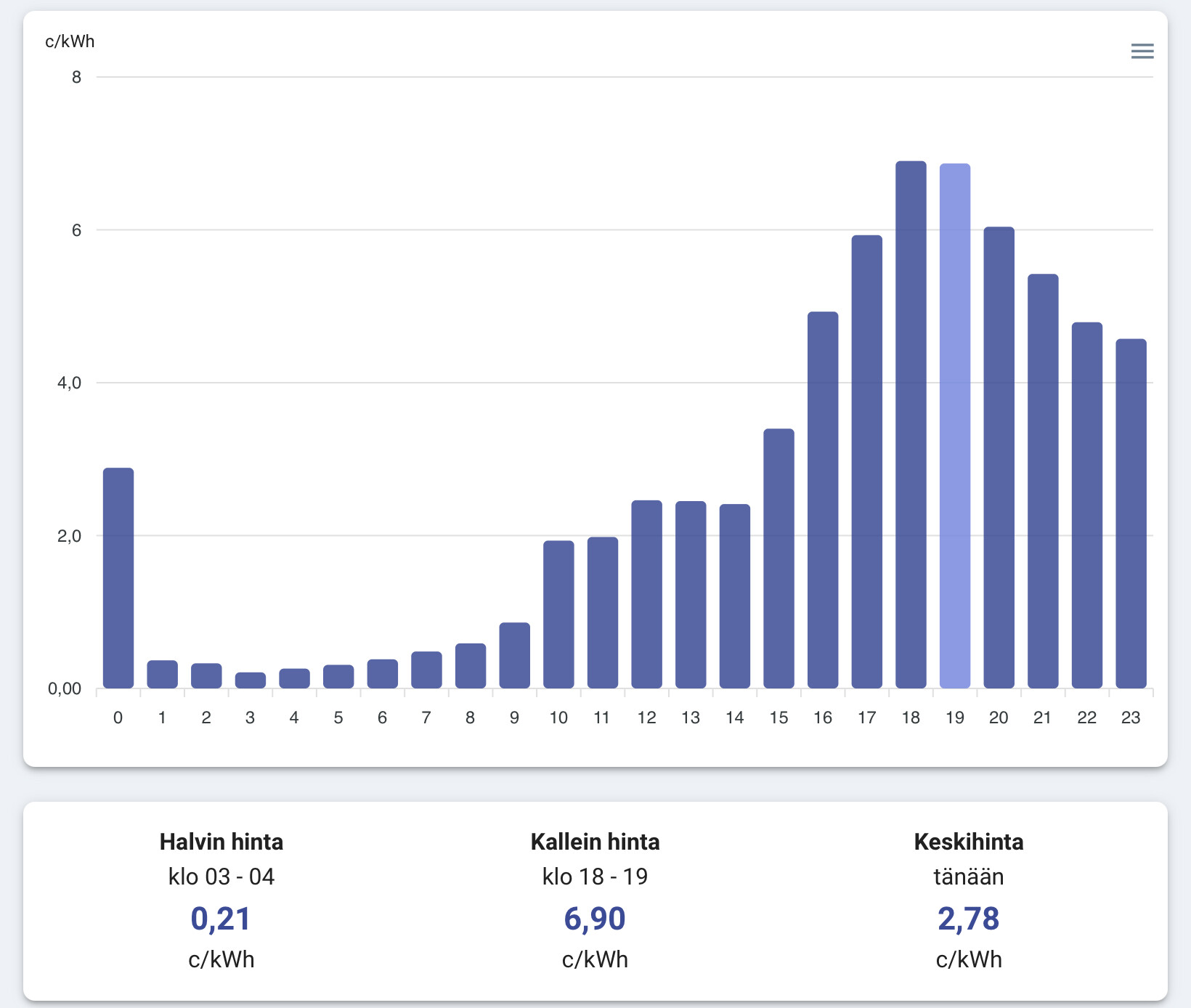

Official prices for this day (21.12.2024) to the left and todays prices according to pbth to the right
It seems that the pbth prices is around 1,4-1,6 €-cents below the official prices.
Have anyone else had similar issues and now how to fix them?
Thanks, Talkkari
Most likely there is nothing wrong and the difference can be explained by looking in to both definitions of “price”. The difference can be explained by different price components like VAT ore whatever price components are involved. So if you want a see a price based on other price components, you have to adjust it your self, or make a clear request to the developer.

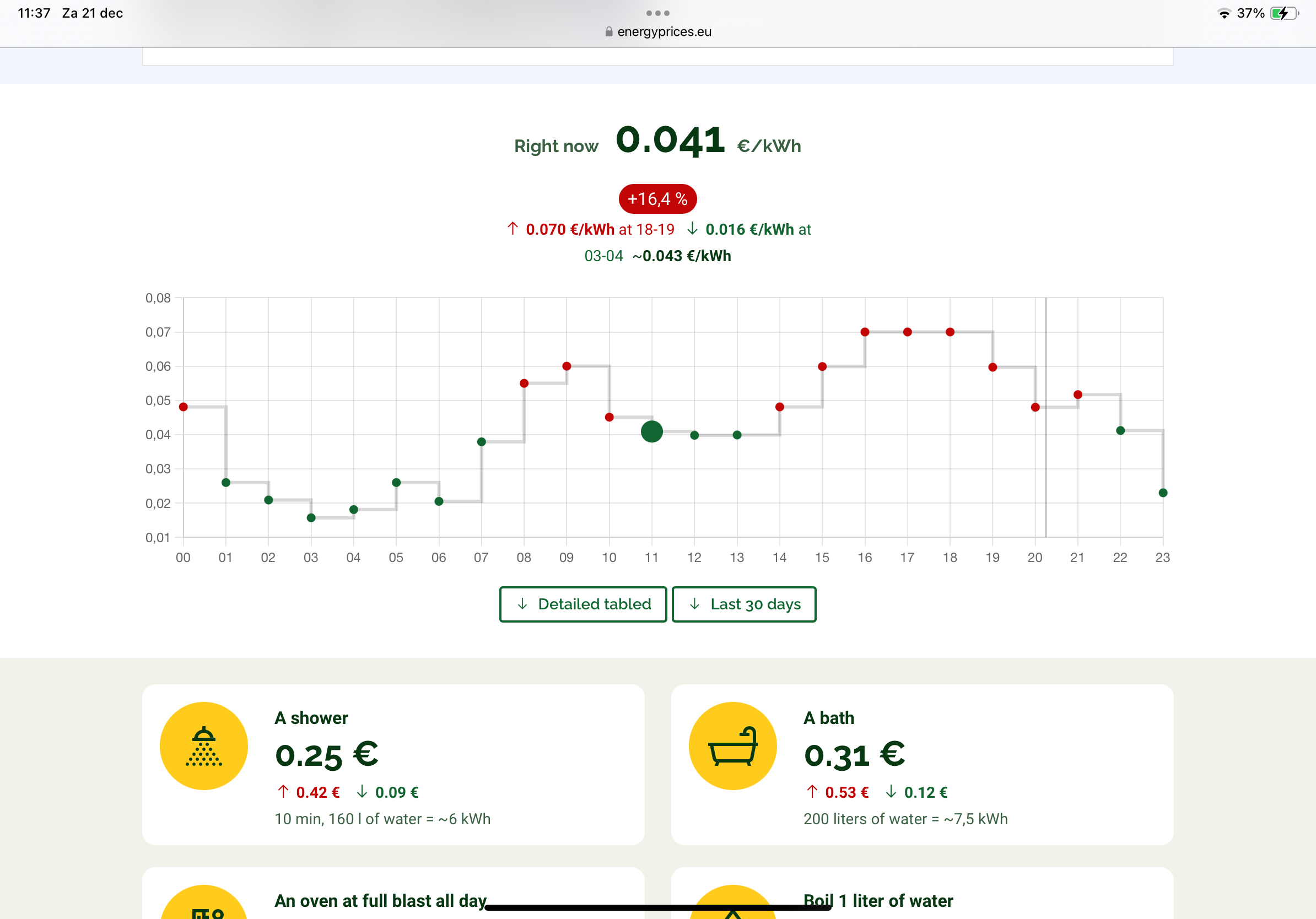

As you can see below, prices of PBTH differs from yours. Most likely because they are updated all the time. So maybe price differences can be explained by different times?

What is your source for the Finnish prices picture. It possibly has the energy tax also included in addition to VAT 25.5%.
This graf shows todays prices with VAT, excluding energy tax.

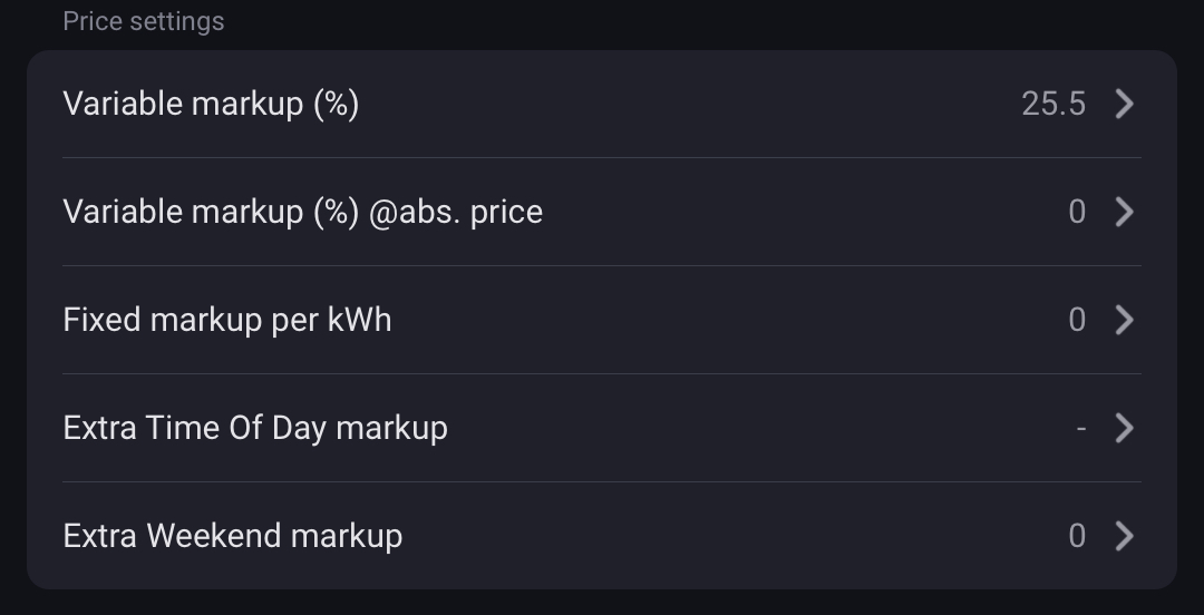

Exactly the same as with PbtH when only VAT is set for the markup %
If you set Fixed markup per kWH to current energy tax / kWh should fix your values.

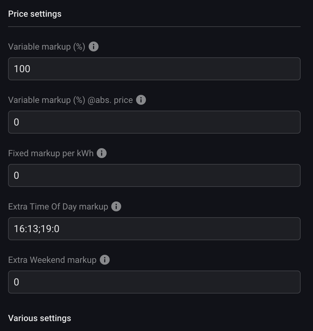

Just looking to get back into Homey, by chance does the Power by the Hour give 30 minute rates?

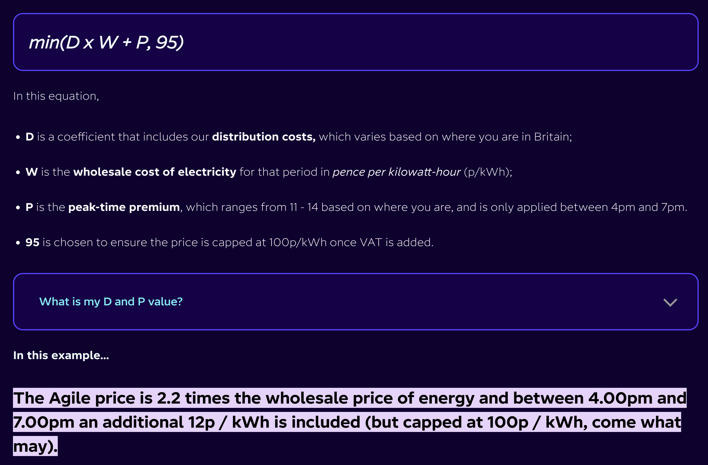

Just trying to get Octopus Agile rates to work but wanted to check some things.
This is what I have set but wanted to see if its how it should be?
This is based on the website where they give the info.
D= 2.00
P= 14
Octopus Energy Agile are based on 30 minute rates so not sure if this will actually work.
