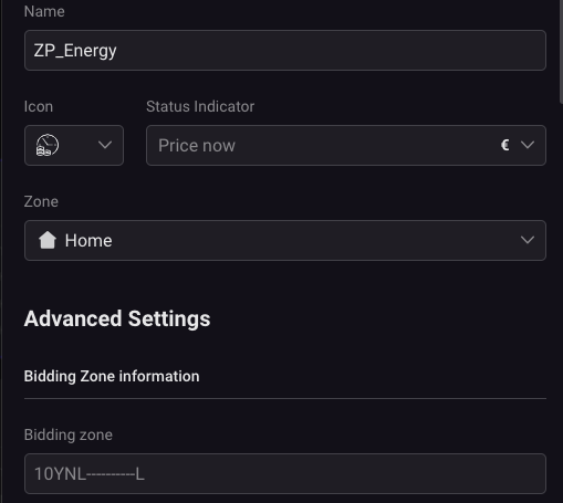

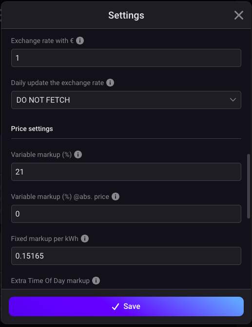

For zonneplan I would suggest to use the following settings:

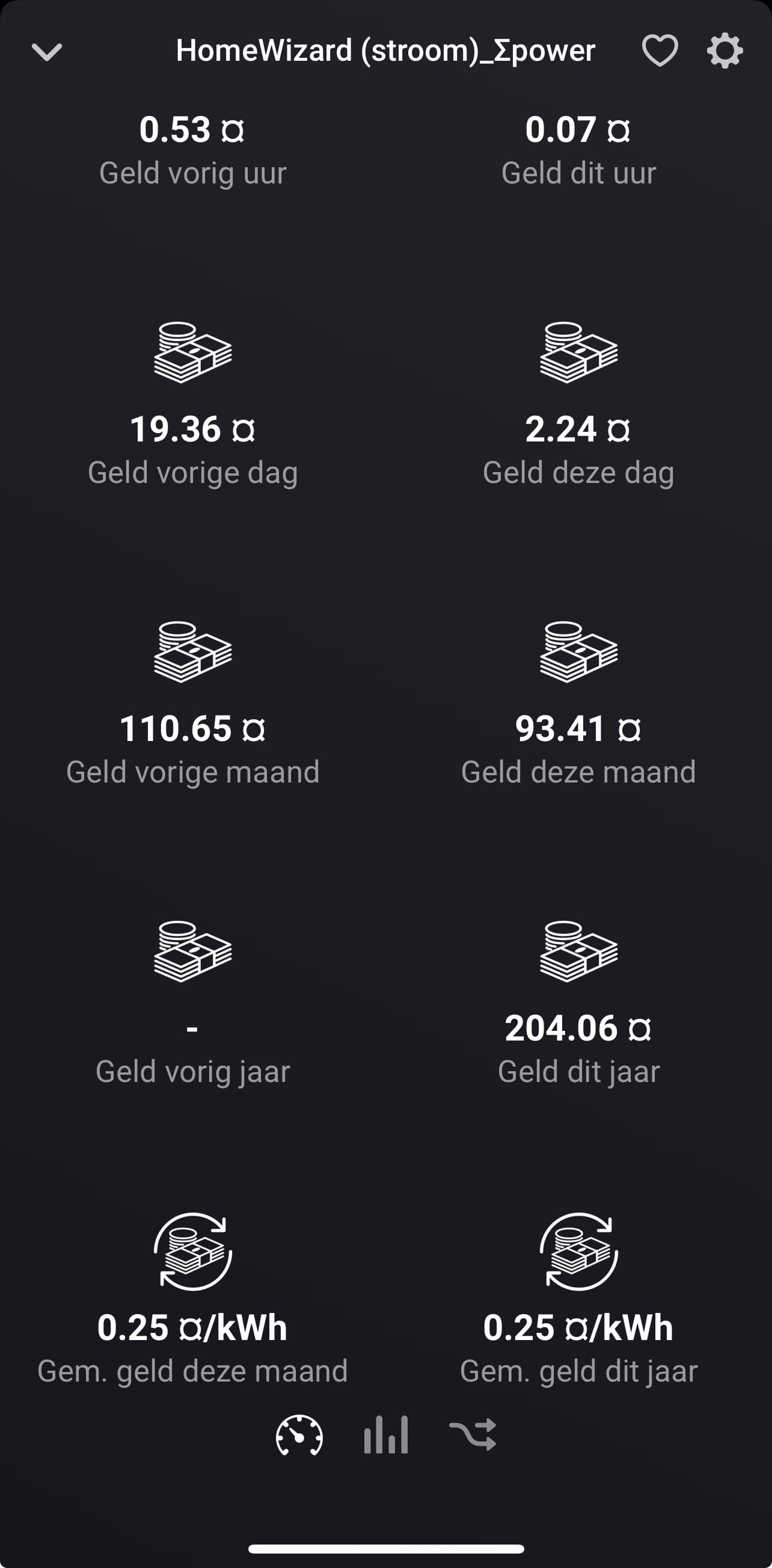

The information you give me I already have in another button, this one below (so it is correct as you say).
But I have another button in my list, the one below, and this one does give the correct figures for use, but not the correct amounts. I am a bit bothered by that.
I am unfortunately having the same problem because the kWh this day is showing the wrong data.

I did what you wrote, see my info below. What I just don’t understand is that the information of kWh previous day and previous month is not correct. Active rate is now correct and kWh last hour is also correct. Maybe it still needs to be adjusted or something? I may be too impatient.
@EdNL The app builds up the history for the device capabilities from the moment you installed the devices and configured them correctly. So just be patient and see those capabilities get better over time.

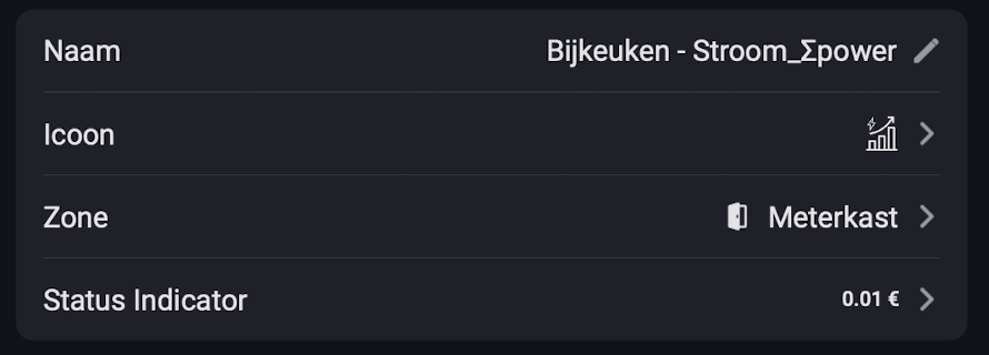

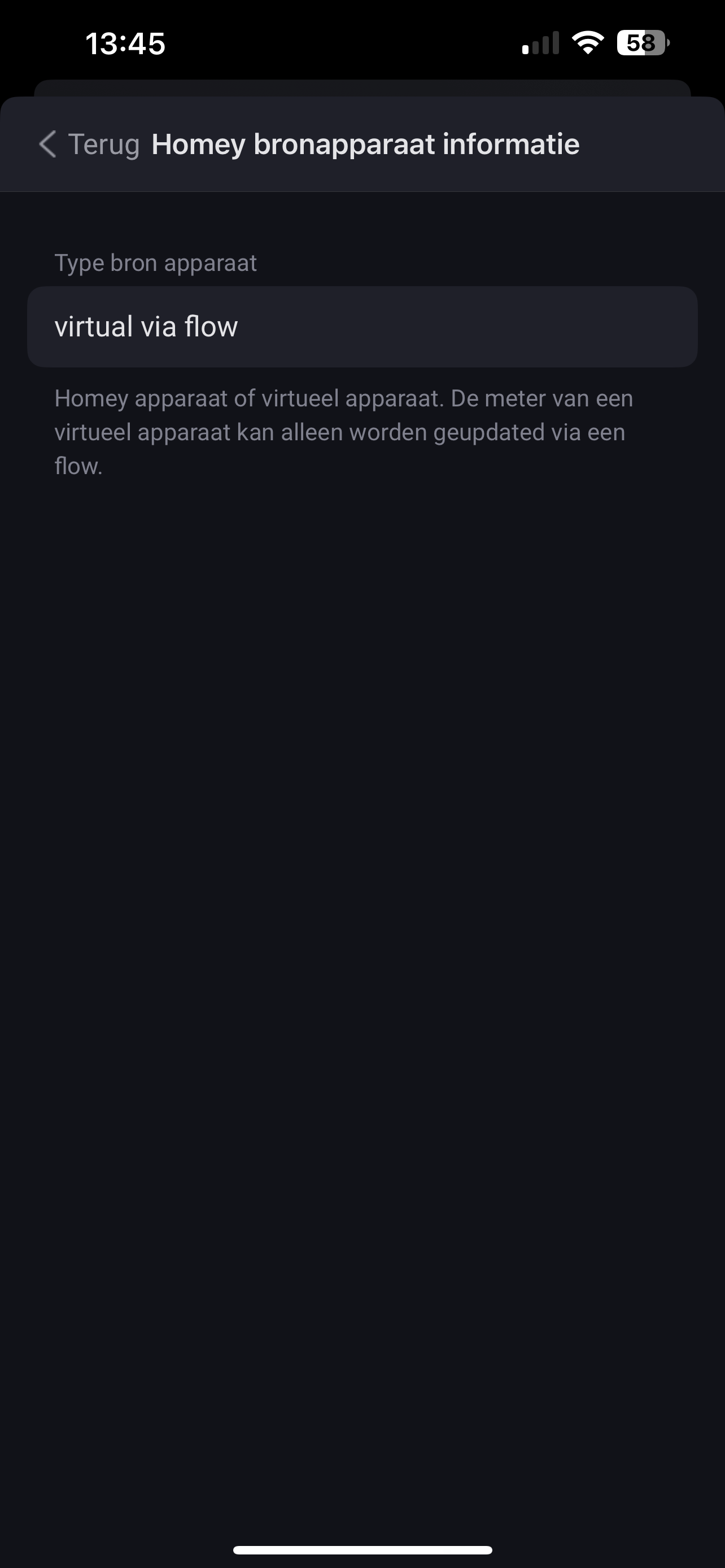

Here I am again, and again with a question. I would like to set up that I can see the power consumption of my lamp. I can switch my socket on/off remotely but I can’t see the amount it has cost me.
I was told that I then have to create a Virtual_Via_Flow and I did that. However, then something must be indicated that I then want to measure in terms of power and that I can see what it costs me. I thought I had to do this under advanced settings under Virtual_Via_Flow button and then under Source device type (virtual via flow). But then I get to see the information below and I don’t know how to proceed.
In Virtual_Via_flow I have already set my Tariff update group (flow or DAP) to 1 under “Tariff” because I also use this for my Homewizard (Power) information (which I have previously asked questions about). Is there anyone who can explain to me step by step how I can get the right price for the right plug so that I can see what the prices/costs are for a specific item (also for example for viewing IR panels, always useful to also view the price with my Zonneplan dynamic prices).

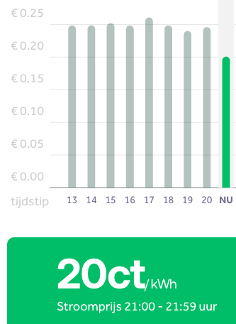

I have seen this after one hour:
Why I can’t see any euro price? Why not @ the Energy platform?
And here I see the price:
Would be nice to know the source. Maybe they didn’t understand your issues, or they don’t know the PbtH app too well.
When you have dynamics prices, it’s all automatically updated, no need for virtual flows and whatnot.

These are my settings:
But taxes are changing on 1 januari, so “vaste opslag per m3” Will be slightly different.

I use these settings for ZP gas, Theo:
The fixed markup of €0,78554 @Torch1969 is using is more accurate I guess.

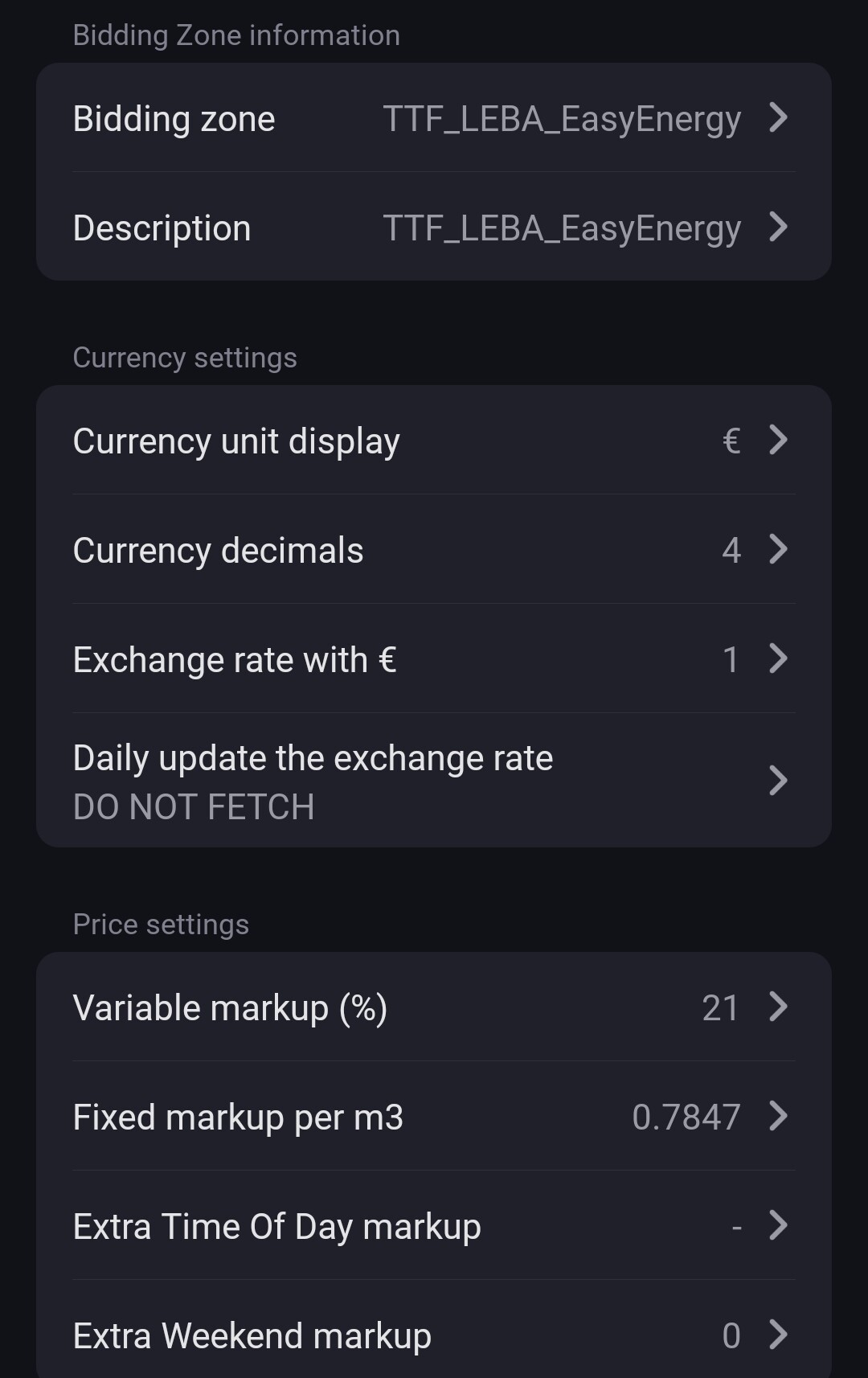

Can’t save that virtual device @Peter_Kawa.
Have made a report. @Gruijter
2ee66089-88cf-4d38-a112-f6793fecfa57
Edit 21:00
Now I can save virtual device with TTF_LEBA_EasyEnergy but there are no values.
Idem after reloading the app.
