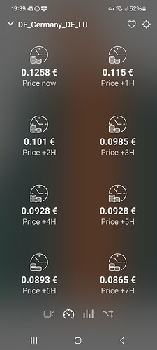

Strange, I can’t see any prices. I’ve already restarted the app but to no avail.
Edit: Crazy now I see the price :rofl:

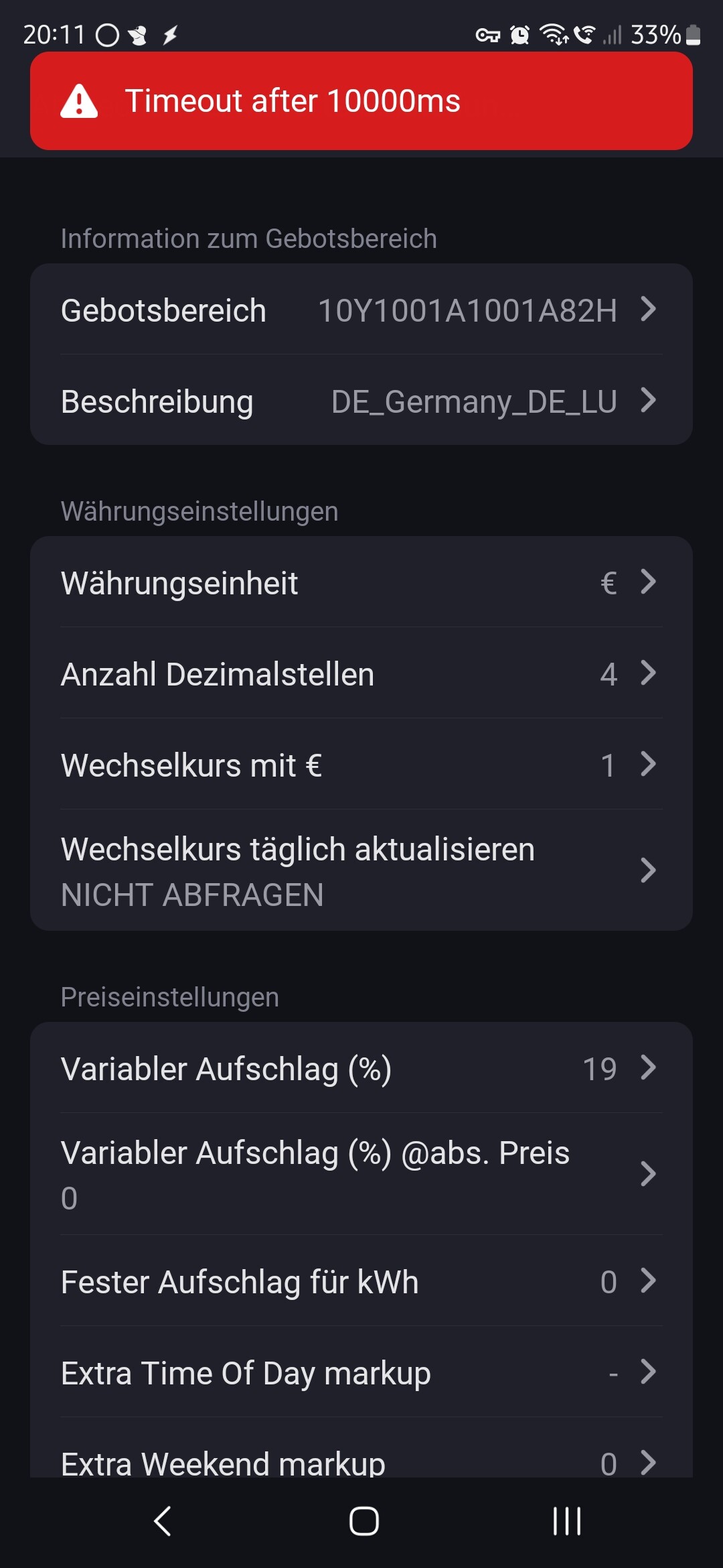

But when I change something in the settings I get a timeout 1000ms error and it doesn’t apply the settings e.g. price per kw/h additional
Is it not possible for me to see the price as shown by Tibber, for example, with taxes and fees? The fees are always changing and are not fixed.
Maybe this helps: When you change settings, the device is restarted by PBTH app. This takes a couple of seconds. Just exit the settings screen and device pages and wait until red exclamation mark on device is gone. After that open device and settings again to see (effects off) your change.

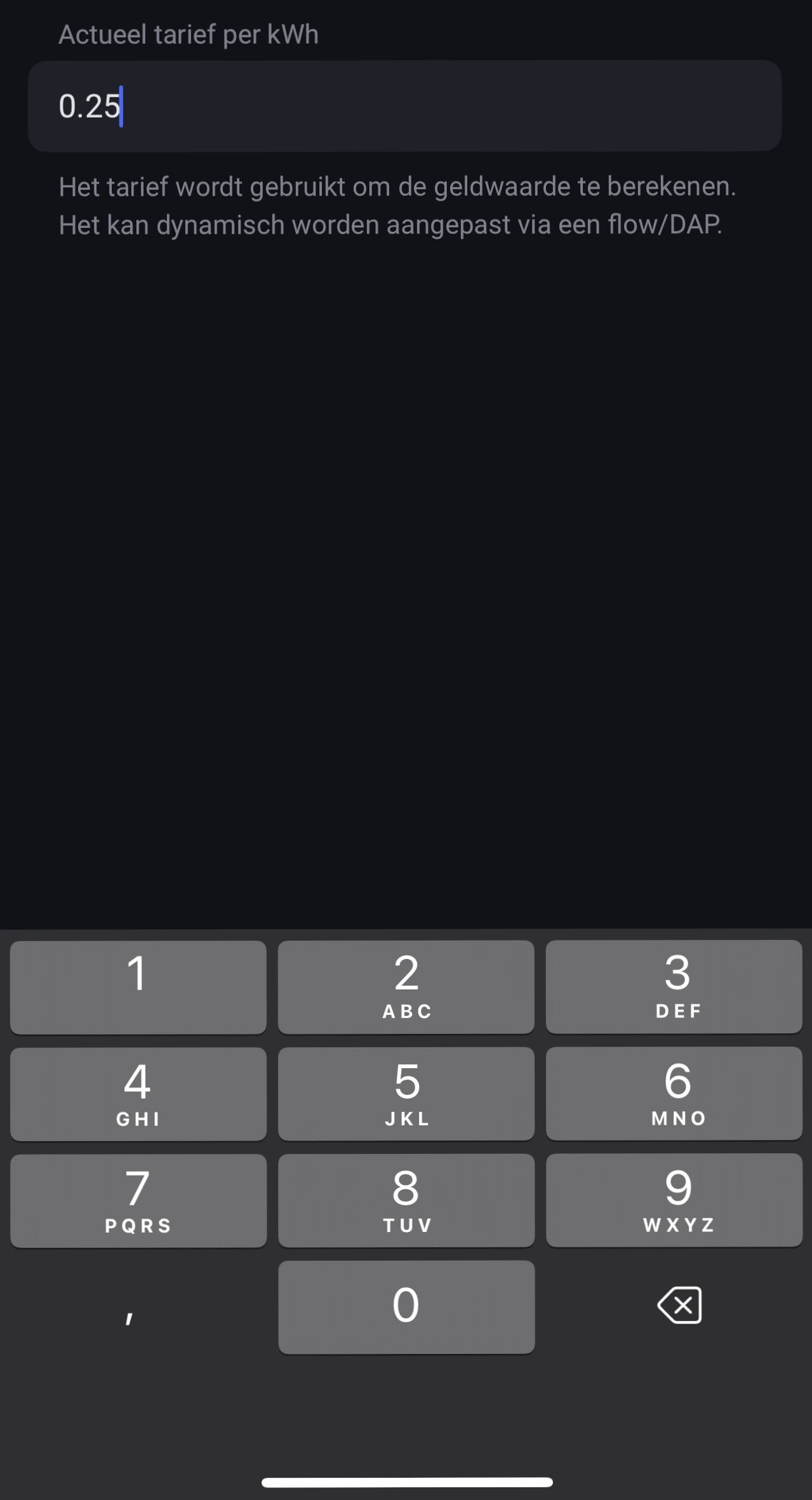

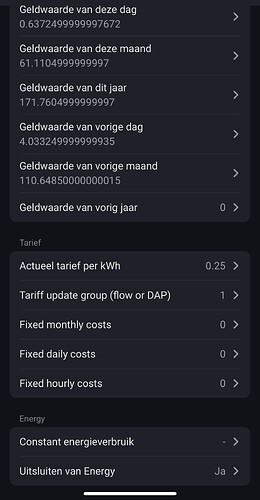

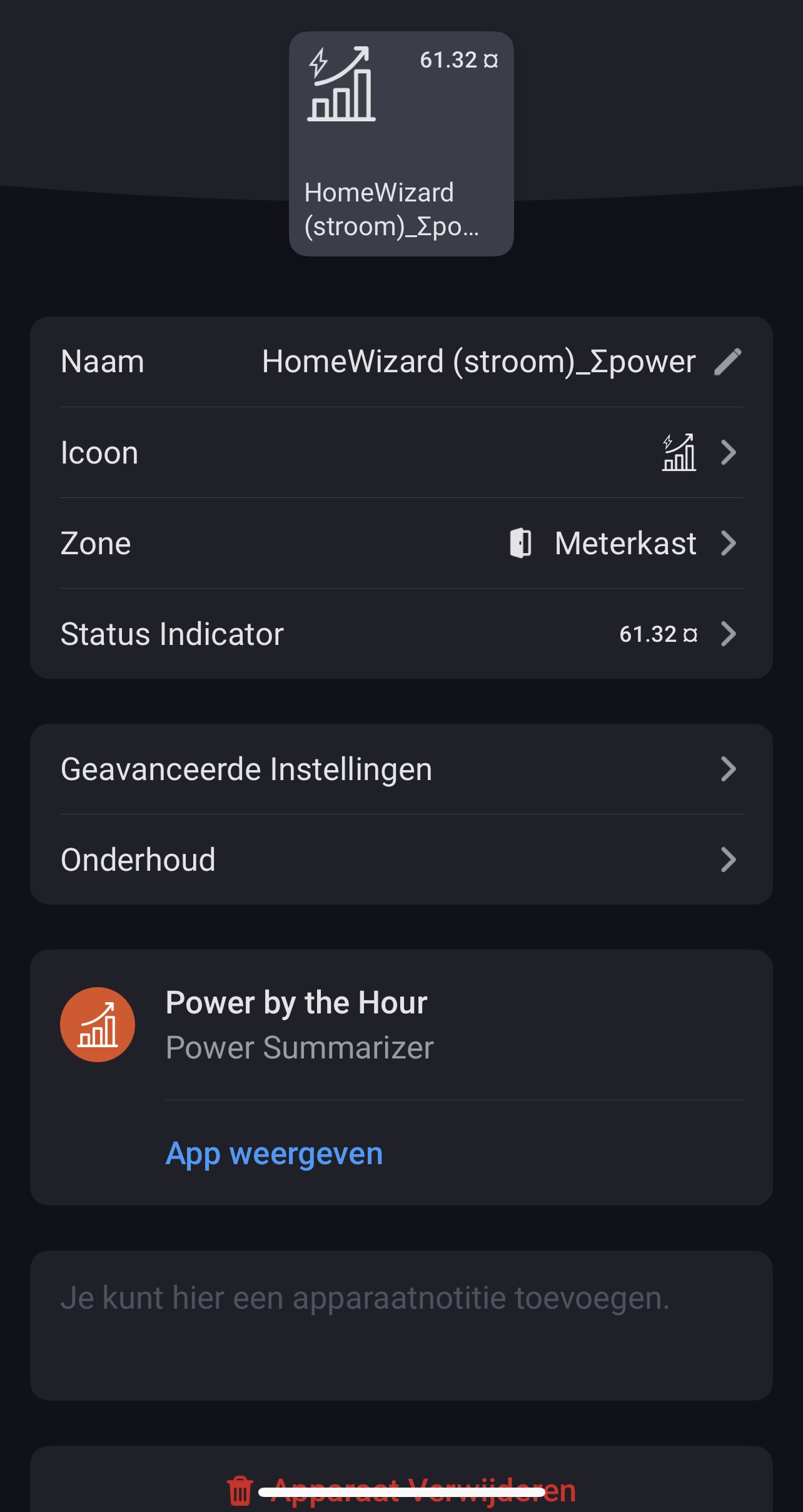

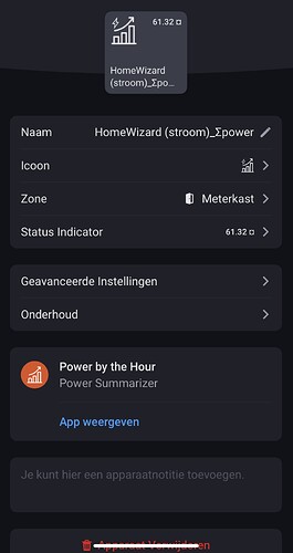

Good morning, I hope someone can help me. I have created a HomeWizard (electricity)_Power (probably to read the prices?).
But I get completely wrong prices, I have a dynamic contract with Zonneplan. Can someone help me with this? I get the comment, when filling in current tariff per kWh (the tariff is used to calculate the monetary value. it can be dynamically adjusted via a flow/DAP) - but how do I create this?
To be sure, I will add all the pictures here in the hope that someone can help me.

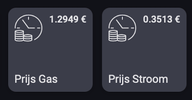

Did you use the “day ahead prices” device of PBTH
Yes, I think I have it:
And I have this one:

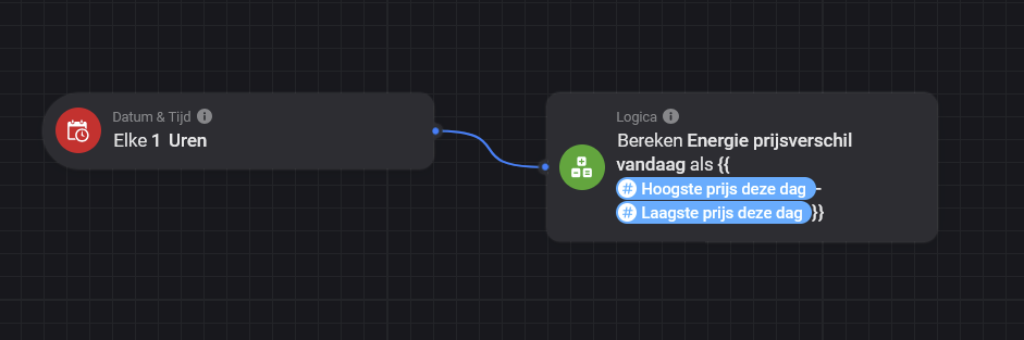

I do it like this:
I just put a simple calculation by subtracting the lowest price of the day from the highest price of the day. Leaving the difference in a Homey variable.
You can use that variable to continue (or not) another flow:
For example I do not charge / discharge a home battery if the difference is less than 0.09.

The solution from Satoer is more comfortable for me, will try that first. Thanks again.
This looks feasible. Why could’t I find this… :slight_smile:.
Will give it a try, thanks!
