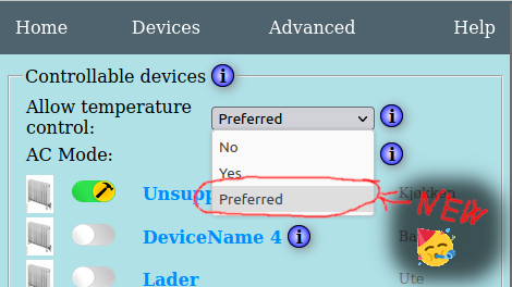

Version 0.20.20 is now out for testing
New features:
  • It is now possible to use temperature min/max to control power tariff instead of on/off - this can be enabled by going to “Controllable devices” and setting “Allow temperature control” to “Preferred”. It is enabled by default for new users, but old users must enable this manually. Note that this will no longer turn the devices on again, only control temperature, so if they are already turned off when you enable the feature then you need to manually turn on those devices. (which is why old users have to enable this manually)
  • Bug fixes:
    • Altherma III Geo pump control should now be synched with the updated Altherma driver.
    • Fixed an issue where a few heat pumps that didn’t set the temperature correctly when in cooling mode.
  • New devices:
    • Added support for no.connecte:thermostat_pm thermostat
