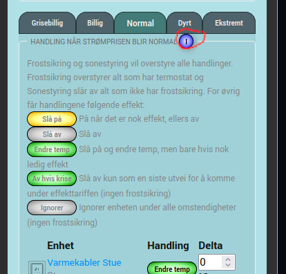

I can choose “Off when crises”, “ignore”, or “Turn on”, and “Turn Off”. Is it “Off when crises” that maybe could be translated better? I understand that when the price is over ex High, “Off when crises” turns the thermostat off when the price limit is reached. “Ignore” makes Piggy Bank ignore the device, “Turn on” turns on the device when the price is high, and "Turn off " (since its gray) makes me think that it does nothing. Then again when you say what you do, I should try to choose Turn Off. But this is related to prices, I want to turn off then I use more power in total to avoid changing the “effect step”. Does the choice also affect this situation?
If you press the information button next to the “Action when the price is xxxx” you will see a description of all the different actions.
The colouring is a way to indicate what is the the best way to use the app to earn money. If it’s green it will be controlled as good as possible, if it’s yellow then it means there is potential for you to improve the setting (by enabling temperature control). If it’s gray then there is nothing to control because it’s off or ignored.
In this case you should not use “Turn Off”, just “Turn On” in replacement of “Change temp” because that will keep the device on as much as possible within the power limit and not touch the temperature.

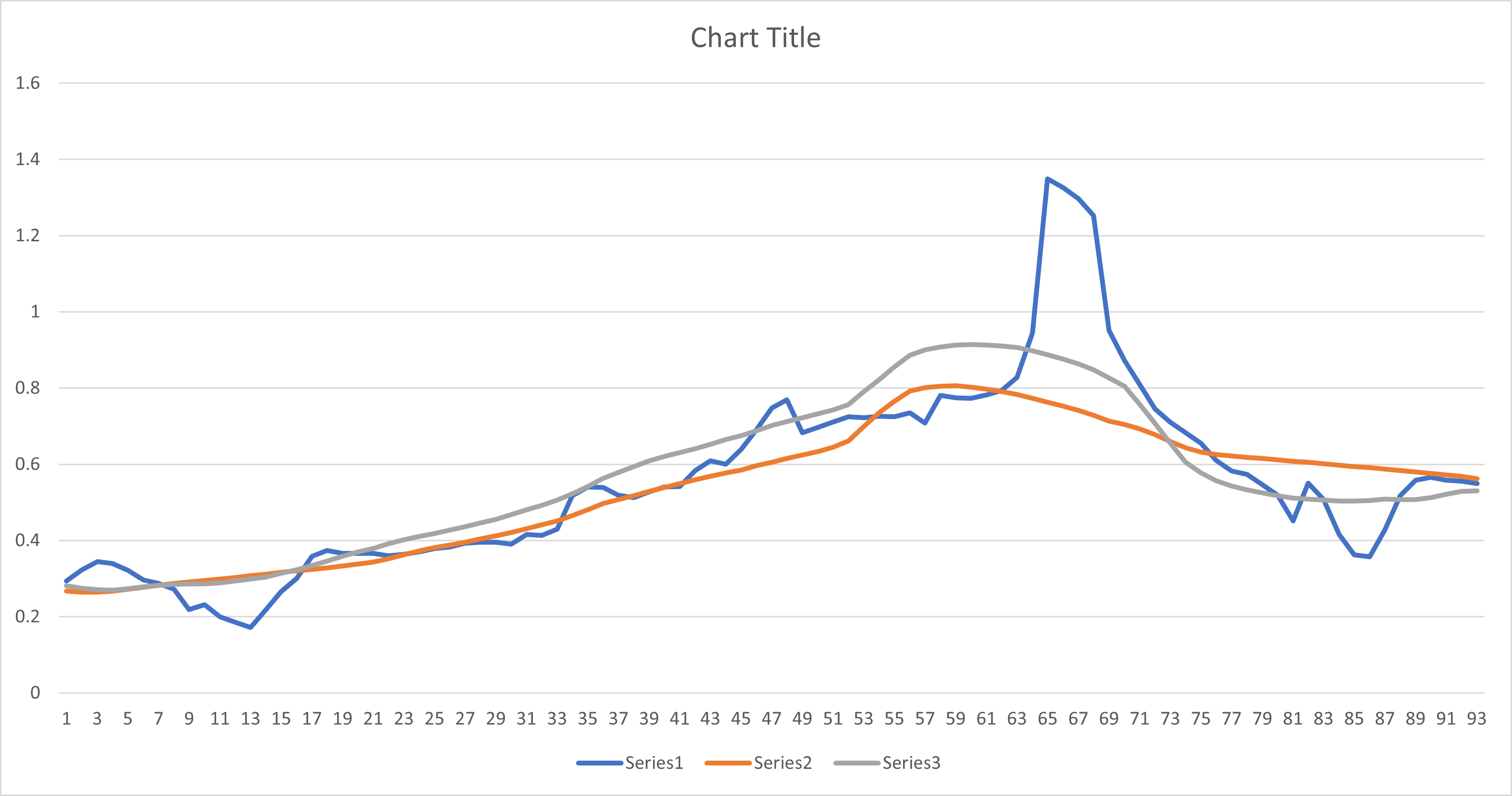

I think maybe your way of calculating the gliding average weights historic prices too much. In the attached pictures I have in blue the prices from NO3 from 12.feb to 16.feb this year. In orange is your calculation (previous hour*17 + future price)/18, and in grey is the average of the 6 previous hours and the 12 next hours. As you can see, the orange is much smoother, weigting historic prices more than the grey one. Is it possible to change the calculation? Otherwise, another option is to just change the wording in the “which hours to base the price on”.
Yes, I think you have spotted an error in my terminology.
What seems to closest describe what I am doing is the Exponential Moving Average (EMA).
I’m using a smoothing factor of 1 whereas the most common one is 2. And there is a + 1 for the number of days that I don’t account for.
I think the quickest fix I can do is to:
  • Change the wording to Exponential Moving Average.
  • Add the +1 to the days in the formula
  • Change the smoothing factor to 2 for completeness
That would probably leave out any confusion.
Will this work for you?
I created this ticket to follow up: Change reference value for prices · Issue #201 · frodeheg/no.sparegris · GitHub
