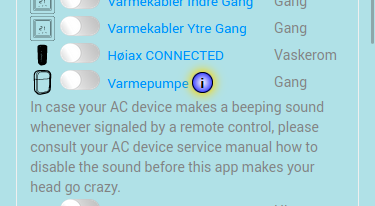

I just tried searching the manual relevant my dow stairs heating pump (the most annoying one) who is a CS- NE12JKE and followed that as best i could but it didn’t work for some reason.
Unless i found the wrong manual this should be the procedure:
4. REMOTE CONTROL RECEIVING SOUND OFF/ON MODE
The Remote Control Receiving Sound OFF/ON Mode will be activated if the Auto OFF/ON button is pressed continuously for more than 16 seconds (4 "beep" sounds will occur at 16th seconds to identify the Remote Control Receiving Sound Off/On Mode is in standby condition) and press "AC Reset" button at remote control.
Press "Auto OFF/ON button" to toggle remote control receiving sound.
- Short "beep": Turn OFF remote control receiving sound.
- Long "beep": Turn ON remote control receiving sound.
After Auto OFF/ON Button is pressed, the 20 seconds counter for Remote Control Receiving Sound OFF/ON Mode is restarted.
I get it to do the 4 beeps, and i press the “AC Reset” button on my remote. But next time i press Auto OFF/ON nothing happens. So I got no idea what i’m doing wrong.
And it still beeps like a asshole :unamused:
EDIT:
Made it work! I had to unplug the sensibo unit first so it didn’t abort what i was trying to do with it’s constant command spamming. Now it’s all silent, finally :rofl: Thx for leading me down that route Frode, i didn’t think it was possible to turn it of from the service menu​:v:

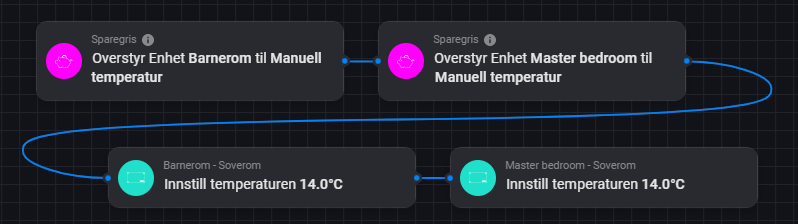

I’m trying to figure out if I found a bug or do not understand the “Override device” function properly.
I use the flow below, to set the childrens rooms to override during the day with fixed 14 degrees since the doors are normally open and get heat from the heating pump.
But during the night, the door is closed and I want piggy bank to control the devices.
However, when I have "more than 2 device set to “override”. In the overview page of “overrided devices”, it will only display 1 - even if I set 2 devices to override.
So… Is only 1 overrided? Or is only 1 dispalyed in the overview, but the devices itself are really overrided?
Mine show 2 Mill ovens as overridden when I manually right click and run 2 override cards (test from here). What happens if you try the same? Will both or just one show up then?
Your flow makes Homey having to set the temperature on a Mill oven AND enable override at the exact same time. If it works when you manually override by right clicking, try changing your flow to execute in series instead of using delays.
Check out “Tidsstyring” under the Advanced tab. Very soon you can get rid of flows like this, given your trigger is controlled by time of the hour of course

The override page only shows the state as it was when you entered the setup (I think). Could it be that you entered the setup within the 10 sec delay waiting for the Ellinor heater to change?
Another thing I have noticed with these flows with selectable devices is that if you remove a device from homey and re-add it then the old flow will still list and link to the previous linked device. This might cause some pain as it would appear that the flow could be working but it is not. If this is the case you can remove the flowcard for the non-functional override and create it again.
