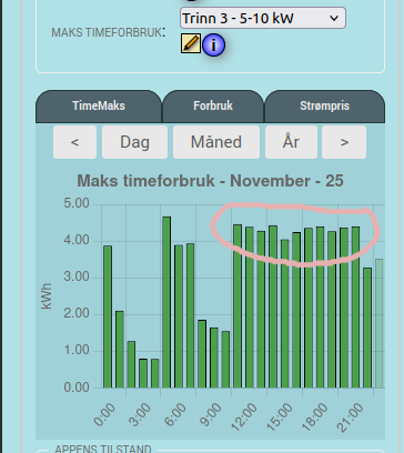

I do not need per hour though. I am looking for the ideal balance between “Nettleie” and Kost pr kWh
At some point I will probably try to automatically suggest when it’s good to change.
When the hourly consumption starts looking like this it’s probably a good time to change though:
If no room is left for moving energy usage between hours then the gain of having a lower power tariff is probably lost due to having to use power in the most expensive hours.
True. thanks

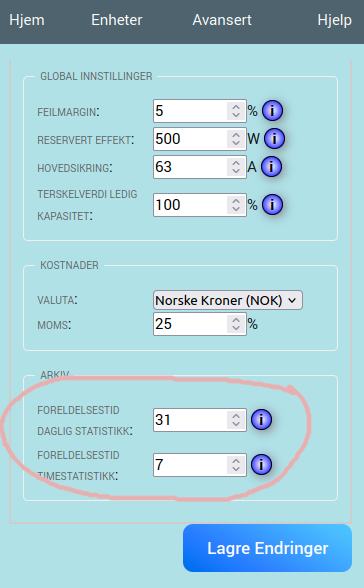

Today I pushed the new version with graphs to stable. There is one thing you should notice though, it’s that the current version show everything that has been accumulated since I added the new archive system. This has never been the plan though as some kind of expiration limit is needed to avoid reduced performance over time. I did make the expiration configurable and it can be set using the parameters shown in the snapshot below, however the data does not yet expire. I did it this way specifically for you to be able to change these limits (or give me feedback on whether the default values are ok or not) before I add the actual expiration in the next version:
So what do you think?
The graphs for “Year” will never expire.
The graph for “Month” will expire after the “Daily expiration time” as this shows data logged per day.
The graph for “Day” will expire after the “Hourly expiration time” as this shows data logged per hour.
The default values are given in number of days.

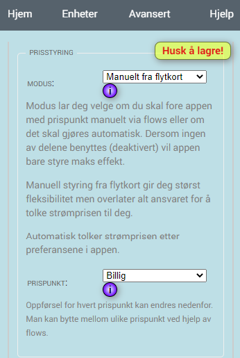

I have setup PB to get prices via a flow,
And tell PB if the current price is high og low. (five levels)
But the app still says: “Du har valgt prispunkt fra flytkort, men ingen slik…”
I do see that PB changes the state correctly.
Am I missing something?
You’re probably hit by this issue.
That is, once a price point changes using a flow it is remembered…but once Piggy restarts due to an update or reboot or whatever reason it forgets, so a new flow need to be triggered for it to remember again. I will do something about this but it hasn’t been very high on the priority list :wink:
