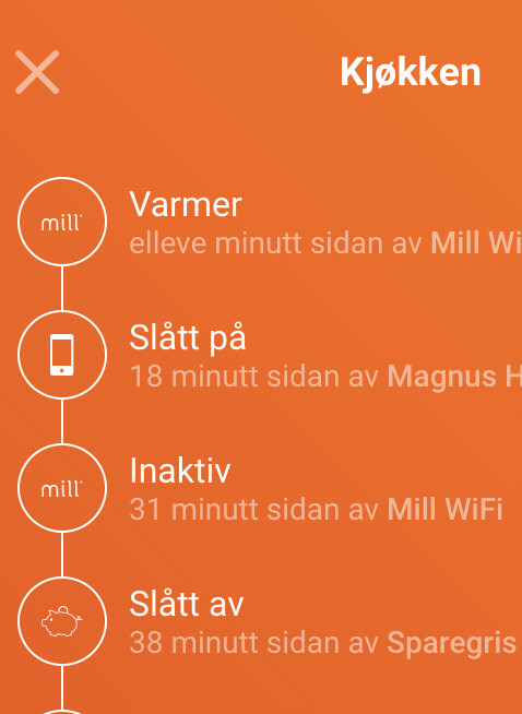

@frodeheg so this bug appeared today again.
As the picture shows: heater was turned off by Sparegris. I manually turned it back on 20minutes later. The same thing happened with all units controlled by the app (7 mill heaters and 3 heatit ztrm3).
Sending state dumps in private message.
