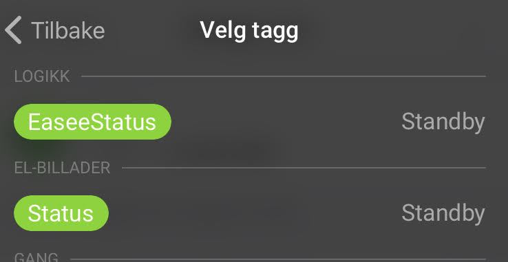

Am I right assuming the “status” tag I see in your flow is the same as the second one in this image?
The second one in my image, “Status”, comes from the charger itself and is read-only, can’t be changed by a flow.
Since your current flow doesn’t set the “status” variable anywhere, the whole point of checking the previous value is not achieved…Read this and watch the video at the top if what I’m saying makes no sense.

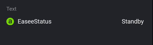

You keep using “Status”, which could work, but I don’t know how quickly it updates. Try to copy my flow example: Use the tag returned by the flow-trigger.
In both the cards where you set EaseeStatus, when you click the “tag-button” to select a tag, click the first tag that appears in the list. It will say “Local tags” is the header “Charger status” as tag-name.
