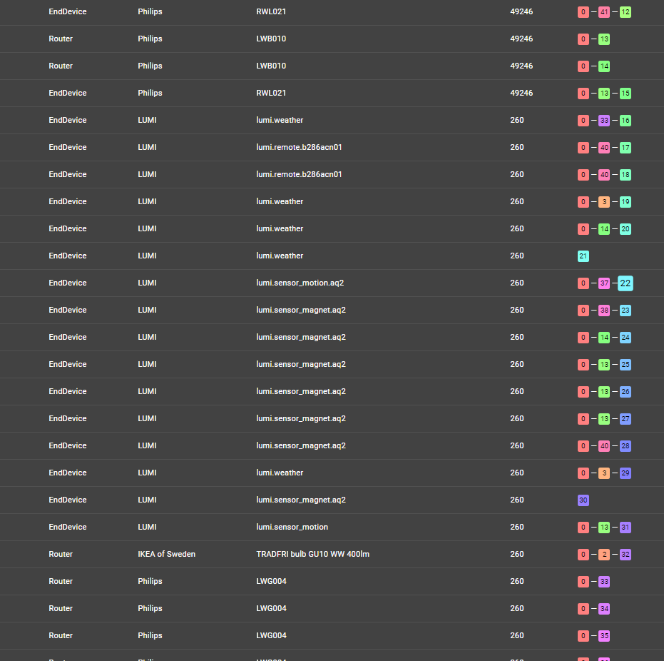

I do have quite a bunch of Philips hue bulbs in my mesh, using this app. And they do make a nice mesh and works as routers. See my screenshot below. #33 till #42 all are philips hue bulb (GU10), I added them 2 weeks ago, and they are working as a router already as you can see
