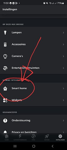

Hi @aunmo, try to connect your bridge via matter. Works like a charm for me. Motion sensors are now responding rapidly
The hue hub can be connect via matter into Homey Pro ?
Hi @Eric_Franckx, within the hue app you can get a matter coupling code. Copy and paste this code within the homey app, underneath-> add device → matter → without qr code.
See images below for the hue app
Step 1
Step 2
Cool thanks
