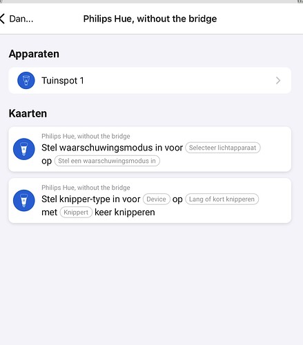

I just bought the Philips hue lightstrip, and I want to have a simpel automation with ‘when the motion sensor turns on, the light strip will turn on’ the only thing is that I see in the ‘then’ section, is two options. (See picture) is there someone who can help me?

You have to select the lamp/led strip first, like “Tuinspot 1” in my case. It looks like you didn’t add the led strip in the app “Hue without the bridge”, as there are no devices in your screen print.
