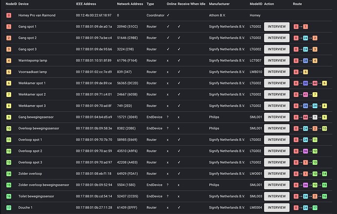

I’ll attach my Zigbee page, don’t see anything weird. Or am I missing something here?
Hmm, network looks good.

Looks fine, Nr.9 shall be maybe paired again without removal, except is it possible that the first added devices were actually not in close distance of Homey - like nodes <24 ? Btw try also to power on/off some of the routers / non battery powered devices and as Johan suggested, also try to let it settle few hours.
I just removed 4 devices (2 lights and 2 plugs) and I see a reshuffle being done within the mesh. Maybe that works. Even the nr.9 you mentioned, during the screenshot it had a question mark but now it’s already connected via other routers automatically. So the mesh is doing his thing :-).

Which of them from the screenshot above have you removed btw ?
Also can you confirm that you did not pair first routers in the closest distance possible to Homey?
eg. when I’ve been recreating my mesh, I have tried to place all products in the desired distance and then start pairing from the closest to the furthers one - but I wonder if you have done the same, because then I don’t understand why the first 24 nodes except of Node 5 are not routing directly on Homey first as they should. And yes - mesh shall survive those actions without any problem and adapt accordingly, that’s why probably Homey is kind of weak compared to Zigbee dongles in HA, yet I remember it was much much worse…
The order of adding them is just as shown here. Some of them were very nearby. The last added devices, were also close, but today I see they also are now direct attached to Homey.
The reshuffling of the mesh is working.
I will remove some end-devices which are direct connected (I at least see one sensor which is direct attached and that is not optimal).
The ones I detached from this overview were number 4 and 5. Two others were already detached when I took this screenshot
An extra update. I didn’t have to pair the sensor again. If I just toggle the “interview” button in the Zigbee overview, it rearranged it to a better place and thus creates a free slot on the direct attached nodes.
I think I’ll do that for every device which I think shouldn’t have a direct attached node.
Let’s see if this helps. Until now it looks a little bit more stable (fingers crossed)
Yep, interview them or just pairing again without removal usually works…
