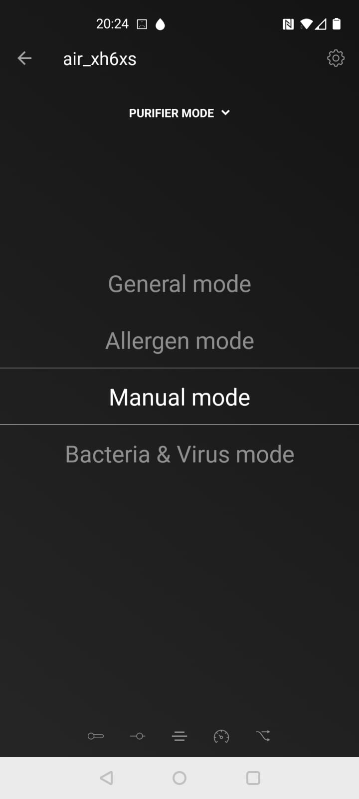

thank you for checking. I cannot set it to manual mode in the app, it always returns to the previous mode. Perhaps therein lies the problem?

The problem is still there (with both versions). The purifier will not change to manual mode via the app (by selecting the purifier mode ā€œmanual modeā€ or trying to change the fan speed). It can only be turned on by pressing the speed mode button at the purifier.

Accordingly the Philips manual the device has 3 Purifier mode: General - Allergen and Bacteria (no manual mode)
But changing the Fan speed change the Purifier to a manual mode. That’s correct because you have manually change the device through changing the Fan Speed (manually on the device self or in the App or in a Flow)
