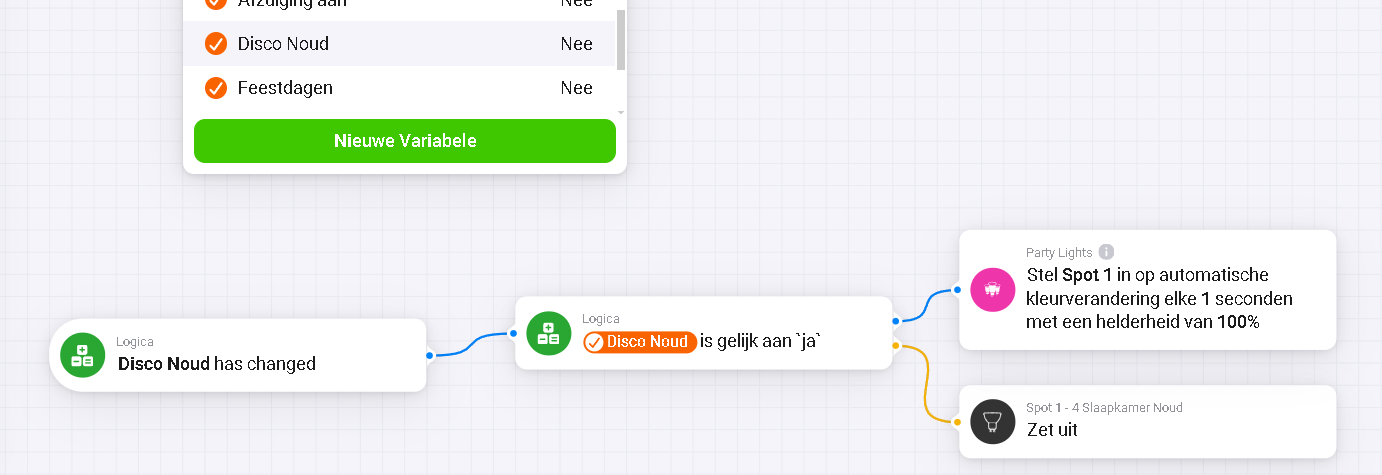

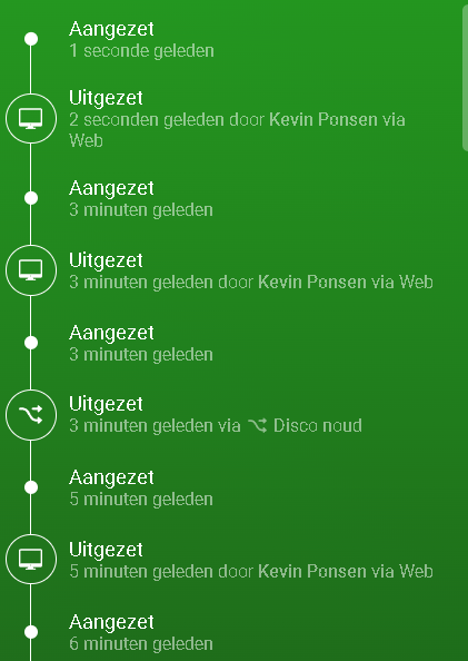

i have a disco scene for my kids
but the lights wont stop if disco stop button is pushed
the light go out and restart directly with disco and dont turn off
even on Homey Pro manual button in the webapp is not turning off directly go on again
cant get them out until i disable the party light app
