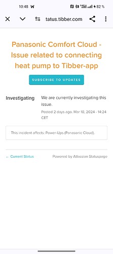

The PCC client package used by the app could theoretically support 2FA, but it’d likely be less convenient than before. (E.g. having to provide a fresh 2FA code every time the access token needs renewal.)
Panasonic could backtrack, and reenable accounts without 2FA. They’ll probably only consider this if they lose business otherwise.
