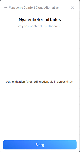

I removed the app and installed the everything again.
I used the credentials that I was using before (when the app worked):
Then I tried to add a new device:
Resulting in the following error:

2024-03-26T08:00:34.336Z [err] [ManagerDrivers] [Driver:aircon] bad credentials
hey Guys,
im running V1.1.2 and keep having the Authentication failed, edit credentials alarm…
i tried re-entering the credentials, restart the app, restart the homey… but nothing worked.
anyone have an idea?
i run the homey pro.
I have version 1.1.3 and get the errors described above.
