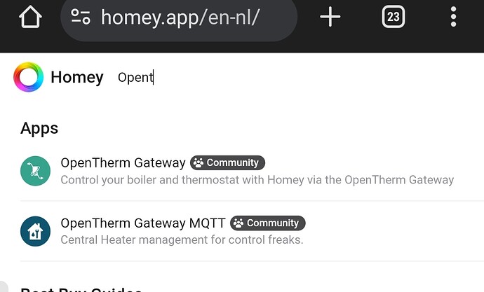

You’re sure you’re using this app, and not the one with the green icon?
Because that one has two AND cards.
Probably the app stopped running, just restart it, and your flows should be working again.
