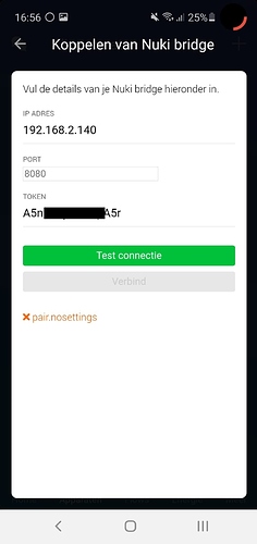

Still no luck in pairing the bridge with the App. Did a factory reset for bridge and lock. Frimware Lock 2.7.30 and Bridge 2.3.0. With https://api.nuki.io/discover/bridges ik get the following response.
{“bridges”:[{“bridgeId”:153587040,“ip”:“192.168.2.140”,“port”:8080,“dateUpdated”:“2020-07-14T12:49:54Z”}],“errorCode”:0}
Tried many many times but no succes. With pressing the bridge during searching and without pressing. On wifi and on 4G connectrion etc etc. any idea?

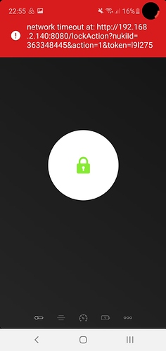

I suceeded adding the lock… now the message appears for a network time out
someothers with the same error?
-------------- FIXED UPDATE --------------------------------
My Bridge was the problem in this. I had continuous dropoff’s in my network, the bridge was not avialable. The Bridge was still in firmware 2.3 and after fiddeling around it updated by it self to 2.6 and now it is all stable.
All these errors indicate a bad network connection between Homey and your Nuki Bridge. You should look into that. According to Homey the bridge is mostly not reachable and I’d look into that first. Connect your phone to the bridge and have a look at the connection details. I can’t rule out Homey though as it’s network stack does seem to be unreliable for some people. If this would have been a common problem with my app more people would have complained about it.
Yes you where right. the bridge was unstable due to old firmware i think in combination with my TPLINK router (DECO P7)
