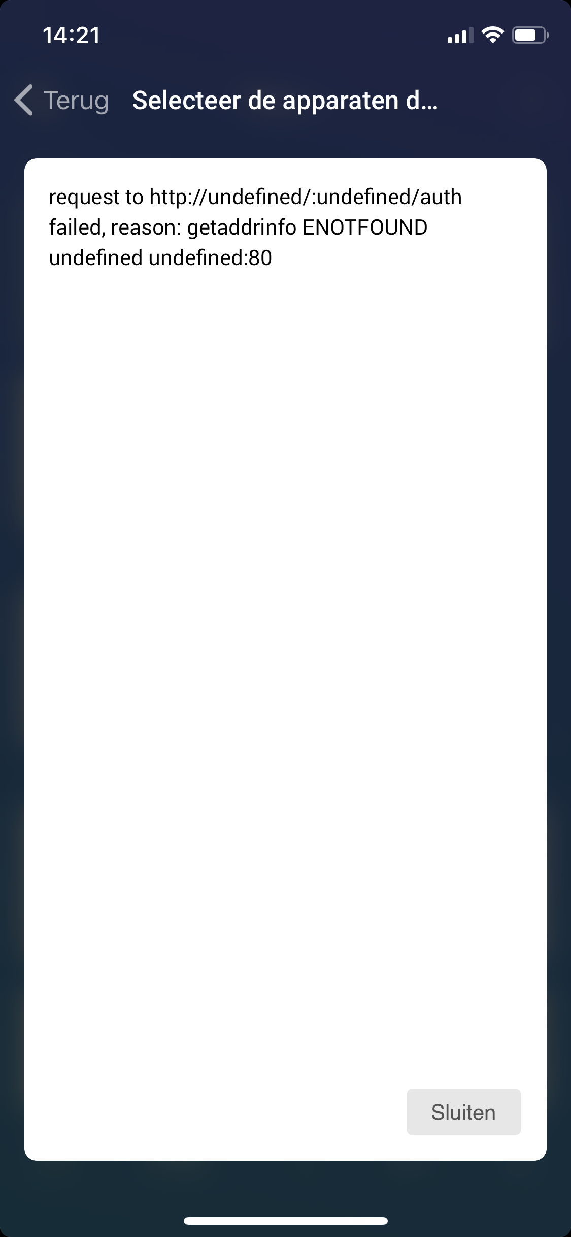

I disabled the official app. When I want to add the Nuki device, I get this error. Any idea?
Interesting. That would suggest the Nuki cloud returns an unexpected result. Upon pairing my app connects to the Nuki cloud to discover the bridge (it’s the only time the cloud is needed).
What happens if you call this URL from a device within the same network as your Nuki bridge?
https://api.nuki.io/discover/bridges
After looking through your source code, I immediately called that endpoint and noticed it is missing the ip property, resulting in undefined of course… interesting. I’ll check my Nuki account if I can find a reason there
