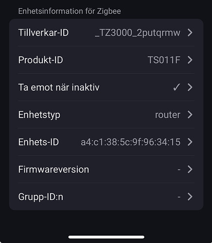

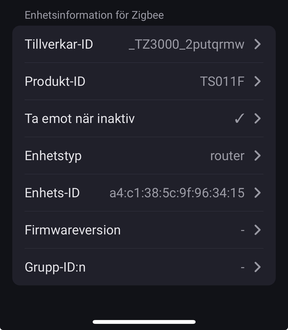

How do I do this best without interferring Hue Stuff etc? Have the same problem atm. Thanks!
