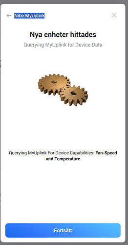

I almost get it running for my Cetetherm Pioneer , tried to reinstall your app but then this time I got this screen and the system looks like it can not pass this , what have happen
@Lars_Herrnsdorf -
Thank you for the sceenshot, I understand the issue better now.
In order for me to check the issue, would you please share your device with me?

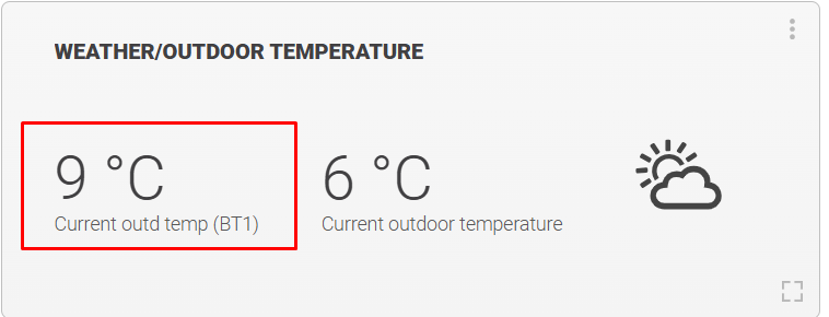

I can also confirm that I do see some datapoint values changing from time to time. For example, the “relative humidity” datapoint is frequently updated, and I can see its changing a bit every minute:
They way the system works is that every exactly 60 seconds, I query the device for all the available datapoints values (I am using the /v2/devices//points API), and if a value has changed, I am triggering an event that will cause the “Datapoint has changed” flowcard to trigger.
As for your question “why the values I have access to are not updating” - can you give a specific datapoint that should have been updated, but was not updated?
You should check both the Capability value in Homey, For example, this one:
And compare it to the same value on the MyUplink website, for example:
If you see that Homey capability value is showing a different value than MyUplink website, something is wrong - send me those pictures and I will try to figure out why is the difference.
