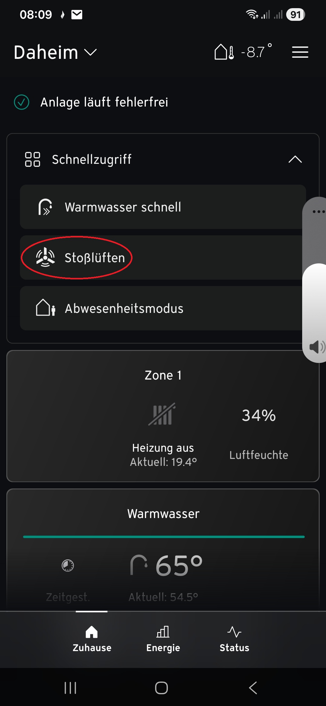

Then I have a question: would it be possible to get the function ā€œVentilatieā€ (hope this is the correct expression) added to the myvaillant app, also see screenshot.

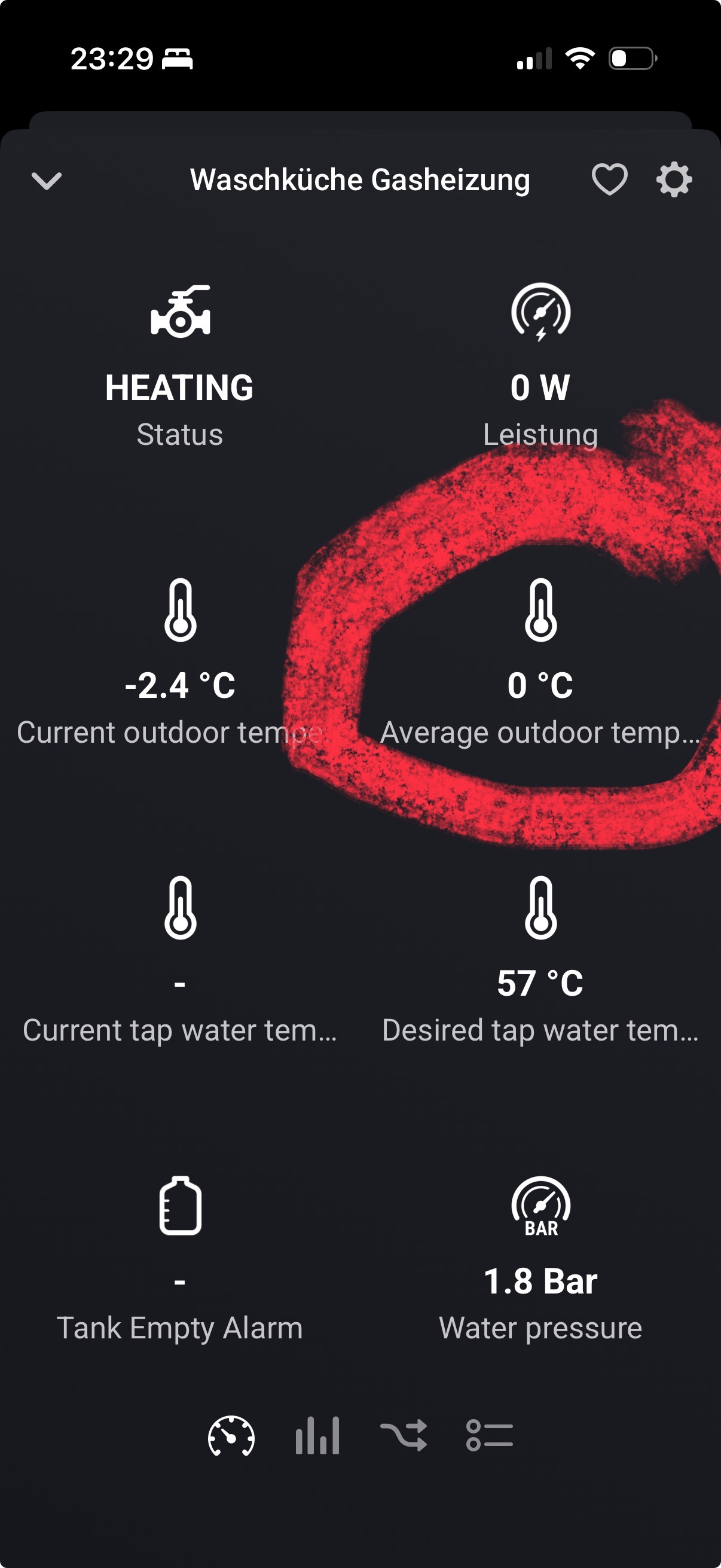

@Pallieter there seems to be a bug with the ā€œAverage outdoor tempā€? In my case it’s not possible that this value goes below 0. Check my two screenshots.
I’ve create an issue on github: Average outdoor temperature can't go below 0°C Ā· Issue #15 Ā· PallieterVerhoeven/Homey-Vaillant-app Ā· GitHub
Good one, will be fixed in the new release. Only positive values were allowed…

This can be enabled in the homey myVaillant applications settings. This way I can see the API responses of a system with the ventilation features.
I’m not sure if I can make this work, because I can’t test it… What options and readings do you have in the vaillant app for this ventilation?
Logging is enabled > 8609dc73-46a4-4638-a753-6392eec62410, > only option is to start ventilation. If you click on it it you need to choose Zone or all zones and then click on ventilation start, see screenshot, it will then run for 30 minutes unless you stop it manually. I would be happy to test if needed.
