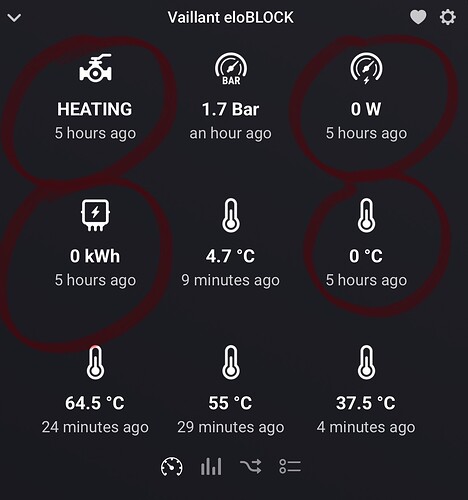

Hi, is it possible to have a look on my system log, because of missing Power/Energy and Current Tap Water data.
I’m running:
HomeyPro 13.1.1
myVaillant 2.0.0
flexoCOMPACT exclusive with VR920
LoggingID: 755e6a90-bffe-46f6-b34c-9b2f1854ec95
thanks in advance, JOE

Hi, since yesterday all my values are not updating anymore. Tried a repair and values come once, waited for an hour, no update. On the android app I do get updates constantly. After a restart of the app no values appear anymore. After setting the app to not active and back to active no values appear. Only after another repair I get up to date values once.
I’m running:
VR921
HomeyProMini 13.3.0
myVaillant 2.0.0
LoggingID: c5aace18-37b1-4518-a242-478fb7500b1e
Same with me. Reset the heatpump, restart Homey, restart the app. The Zone (gateway/thermostate) does give data. The Vaillant Android app is working fine.
Something is suddenly blocking the heatpump data to Homey.
Same here, restart everything and I get data then it stops updating again, I’m on iOS.
Interestingly I had a similar issue yesterday with another homey app and the developer said it was a security issue blocking my homey which he fixed (may not be related but a bit of a coincidence)
Same here.
I’m wondering if Vaillaint isn´t blocking our api calls from Homey since their infrastructure will probably suffer heavy demands from android apps with the heat waves in Europe.
Glad to see i’m not the only one though.
Same here, one off update after reset of internet module.
