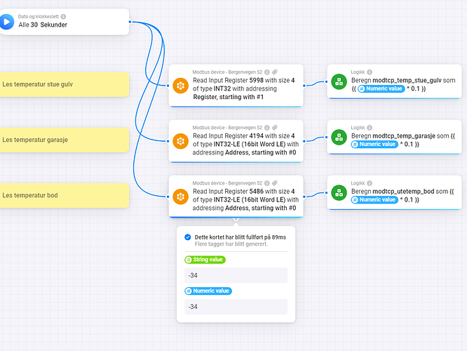

Short hint: when using INT32 or similar, the set size from flow card is not uses. The amount of registers is read based on data type.
With type BYTE you should use a size of “2” (registers, not bytes).
The 00 00 at the beginning and at the end are irritating. Are you sure the 5998 is a register number and not an address?
The 5998 is the modbus adress and give me the correct value, as you see in the picture the reading are 220 and it correct when multiplied with 0,1 = 22,0 dgrC
There is an offset of 1 between address (starting at 0) and register (starting at 1). What is right should be documented in the manufacturers manual.
If’ the correct decimal value should be -1,3 (-13 as INT32), then FFFFFFF3 should be the right byte value.
I think you are 1 register off resulting in trailing 00 00 bytes.
In your case, the app would read 0000FFF3 and that’s 65523 as INT32.
Please change your flow card to “Address, starting with #0”. Then you should get a Byte result of FFF3FFFF reading with a size=2.
Sorry about the delay… I was stucked n a New Year dinner :slight_smile:
I tried to change the starting point to #0…here is the read value
Happy new year :grinning: Was also away and today it’s a lazy day.
But back to your example.
FFDE FFFF look right…if -3.4 would be the right value.
I used this converter:
https://www.simonv.fr/TypesConvert/?integers
And FFFF FFDE is -34 as INT32.
So it seemsyour device is using INT32LER (a lower endian variant where the registers are read from right to left - not the Bytes).
Perfect Ronny… thank you so much for your support. :grinning:. here is the result when trying another register type
… The correct value are -3,4 dgrC

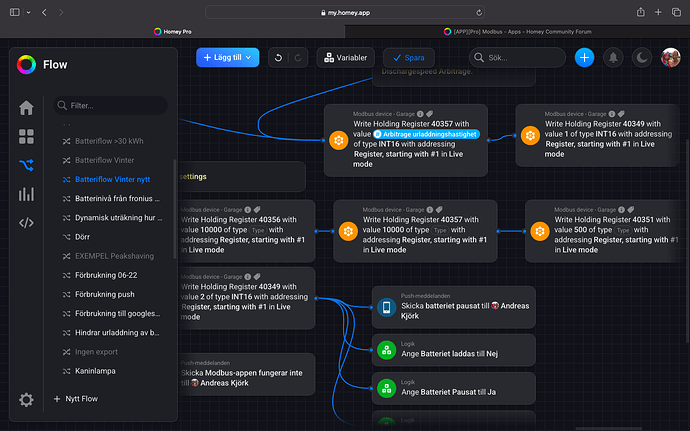

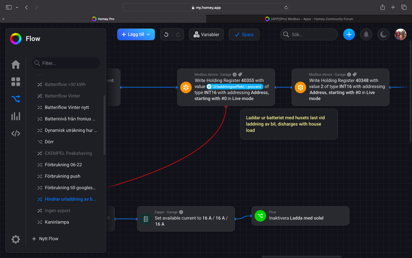

Hi, I need som help. Ive tried to find the problem. My battery discharge to much and I think.
I have five different times I control my battery. Charging cheapest hours, Normal settings, paus, arbitrage and when my car Is charging. Now I have told the battery normal settings but it discharges to much so I export. This happens sometimes and I think its when it happens in just that order, for example paus to normal, or charging to paus to normal. Or is the problem that I write to the wrong registers?

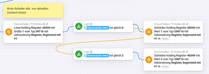

Is it possible in your flows that register 40349 should be set to 1 and at the same time?
Or in other words: Is it possible, that one flow sets the register to 1 and after that a secone flow sets it to 2? That will overwrite the “1” from the first flow.
If both - charge and discharge rates - should be active together, then you have to set both boolean flags with value “3”.
Example for decimal/binary representation:
1 = 0001
2 = 0010
3 = 0011

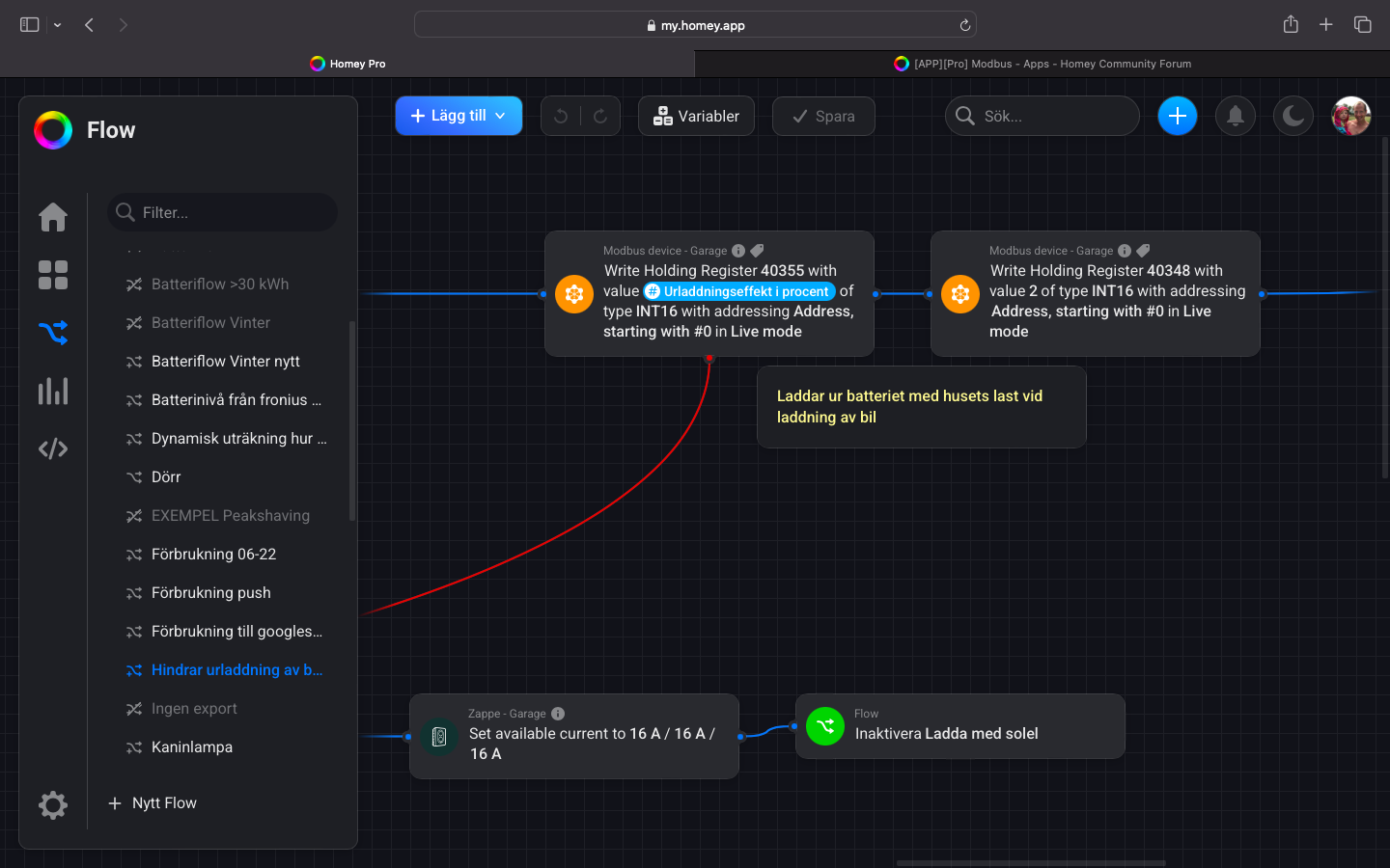

I needed this to add a discharge rate for car charging from grid (to avoid discharging battery too much) and perhaps activate battery charging at cheap price in parallel.
I’ll add some screenshots later…

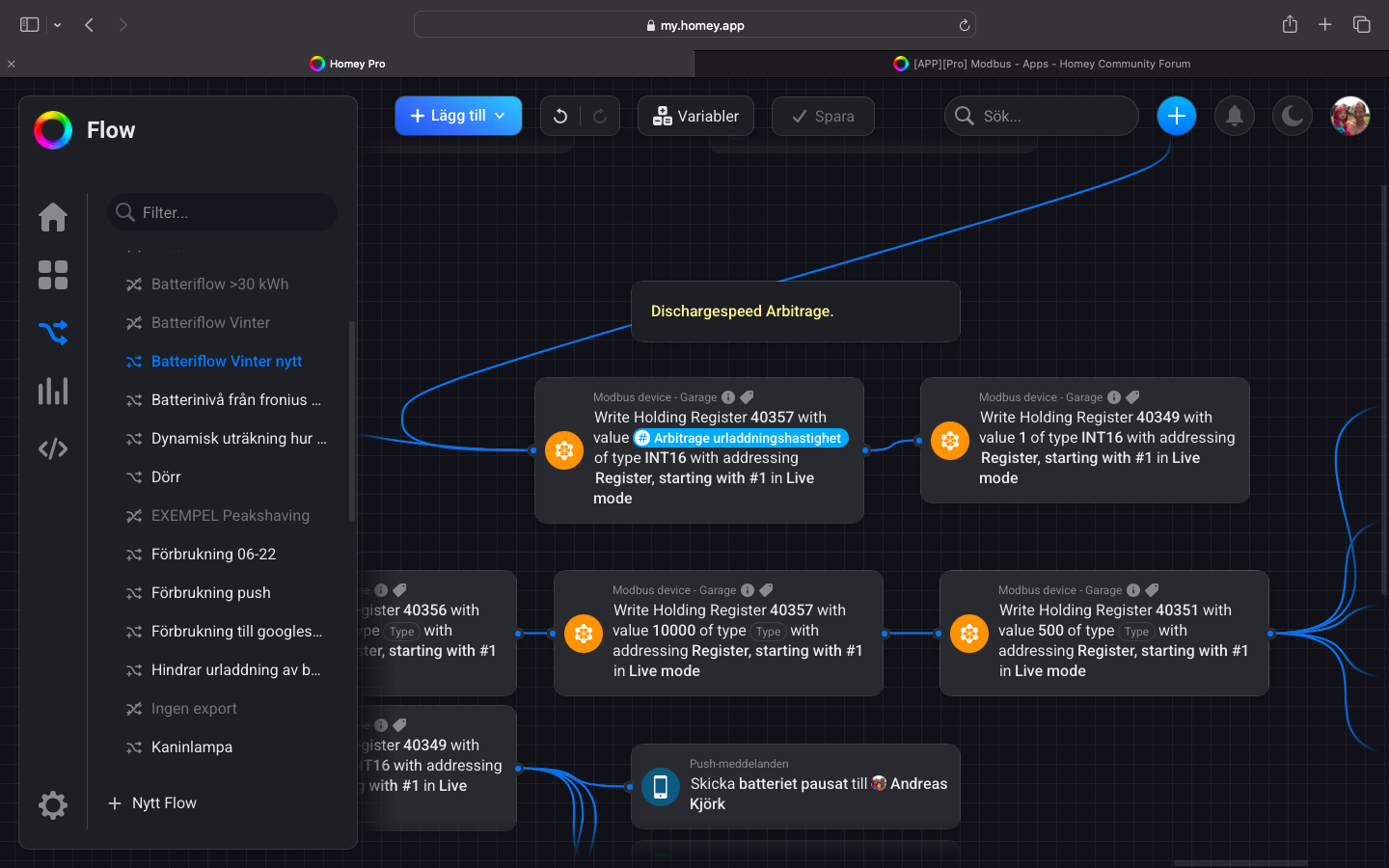

Some screenshots…
  1. There I want to set the boolean value to “1”. If it’s already “2”, then I add the boolean 1 and set the value to “3”.
  2. And the reset is similar.
This way you can combine both charging an discharging limits.

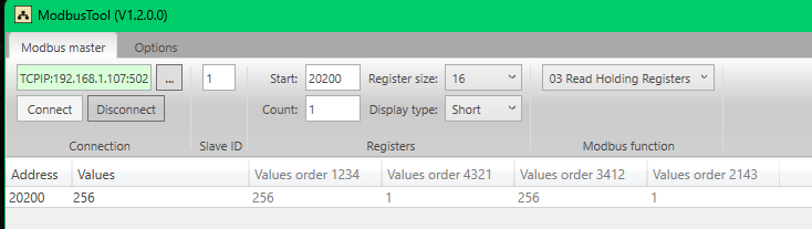

I have a Nilan application that reads all values, and I also tried to use ModbusTool
When I try to readout sensor T6 I get
with modbustools 20003 returns 0
Nilan software reports
So the modbus tools reports the correct value (x 10) under “Values order 4321” (note; the temp in the Nilan software was -1.4 on the exact moment Modbustool got the value 14)
But in Homey I can’t get a reading that seems like the temperature
I tried all options in the flowcard, but it’s either 0 or these extremly small numbers
Some info from the Nilan Modbus manual
Some temperature sensors
When I try another setting (20200, a on/off setting) I can read a 0 or 1 (in Modbustool) depending on the setting in the heatpump in Modbustool so that works, it returns this:
The “normal” value is 256, is that a factor I need to use?

In this screenshot, you are reading an “Input Register”. Using input register in Homey in right.
It seems the 20292 is an Address, not a Register, so use “addressing Address #0” in the flow.
Addresses are starting with 0, the corresponding resister (for documentation/manuals) is just the address+1.
You are reading 3 registers (Count=3). It it right? Such numbers are normally stored in a single register. But based on the order 4321, the wanted (smallest Byte) is stored in first register :slight_smile:
What is Endianness? Big-Endian vs Little-Endian Explained with Examples
So I think you should use a LE-type like INT-LE to read a Little-Endian value.
And use INT16-LE instead of Float. Most devices are using integer values with a fixed multiplicator (14 as value, *10 as multiplicator). Some devices have a separate register where you can read the multiplicator from.
Using INT16–LE should return the “14” (I hope).
There you are reading a “Holding Register”. You also have to use “Holding Register” in the flow card. And ist should also be INT16-LE based on the Byte order 4321.
