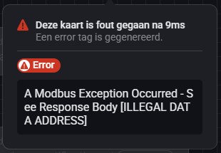

I’m hoping someone can help me a bit to start working with this app :slight_smile:
I’ve an Oekofen Pellet heating that supports Modbus TCP. I’ve configured it as Device 1 and looks like it is connecting. But I can’t read any register, so probably I’m doing something wrong.
I’ve made some screenshots, can anyone get me started with this ? I would be very gratefull :slight_smile:
Screenshot of the register manual:
Screenshot of the error i’m getting:
Thanks!
Jan
Are you sure that are Input Register and not Holding Register?
You can try the Holding Register flow card instead.
And the register range has a prefix in most cases like 40xxx instead of your small numbers. Please check your manual if you have to add such a range prefix.
Like this then ?
Then I got the same error… I only have a manual with the adresses but nothing more then that…
The 40xxx was an example from Fronius.
Do you have an URL to the manual?
PS: This one?
It’s not so much information about Modbus…
No details about
  • is it using register or address?
  • is it using offset for different register types (the thousands prefix)
  • what register type is used (inpout/holding register)
I have 2 Manuals in PDF, I just placed them on my hosting since there not on a website of Okofen:
I don’t now what type or register/address it is. Doesn’t look that clear in the manual for me ?
