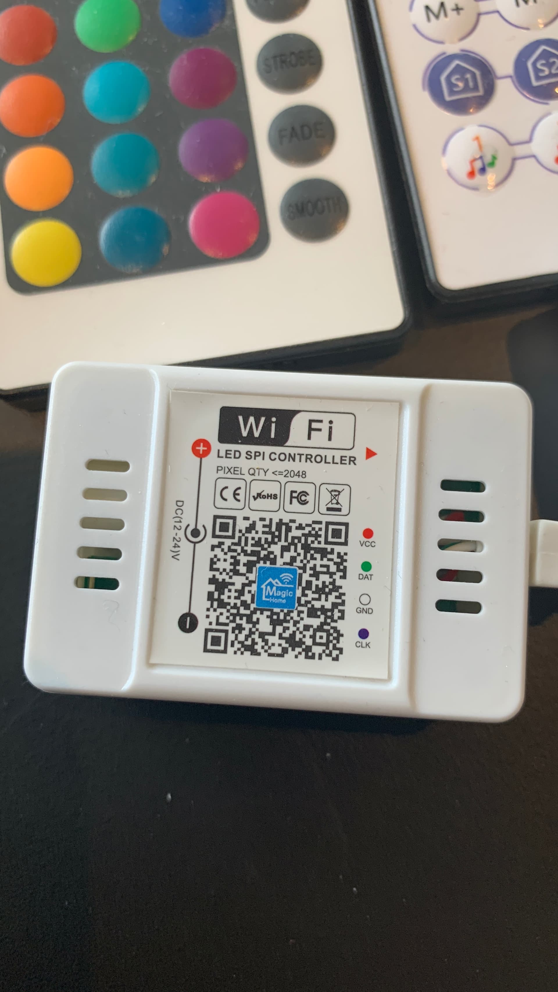

Here is the image that was missing when adding the device to the Magic Home app.
I changed the device model and restarted the app and even Homey but it doesn’t work
@Geoffrey_Quiroz do you know which controller it is?
Honestly, I have no idea; it looks like the classic Magic Home module.
How can I find out more?
@Geoffrey_Quiroz you can also upload your image into the forum. Makes it easier to follow :slight_smile:
Can you find a number inside the magic home app?
When I add the device to the Magic Home app:
and it appears on the PC software
The script gives this:
I investigated the network problems but I came up empty handed, Homey and the ribbon are on the same network
This device
@Geoffrey_Quiroz I hate to say it
But that device is not supported
Magic home changed significant and this product is not configured as far as I know
