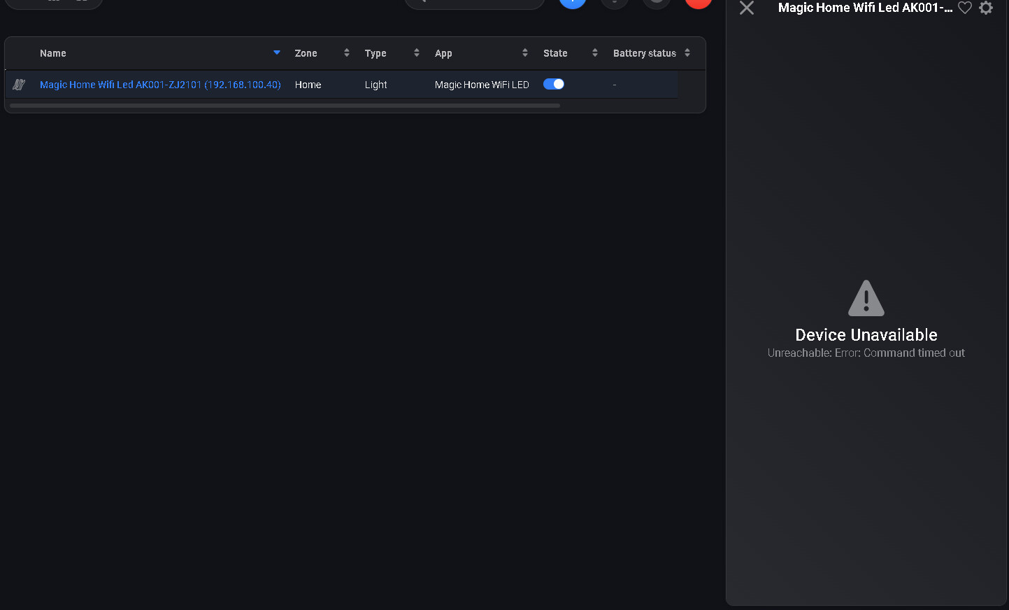

managed to connect it…
But got other issue
@Alex069 really looks like some connection issues in your network.
Will check, be back with some updates.
Also let me tell you the steps that I took.
1)LED Controller in Pair Mode
2) Connected to the Mobile App
3) managed to connect it to Homey, but not so much control from Homey.
