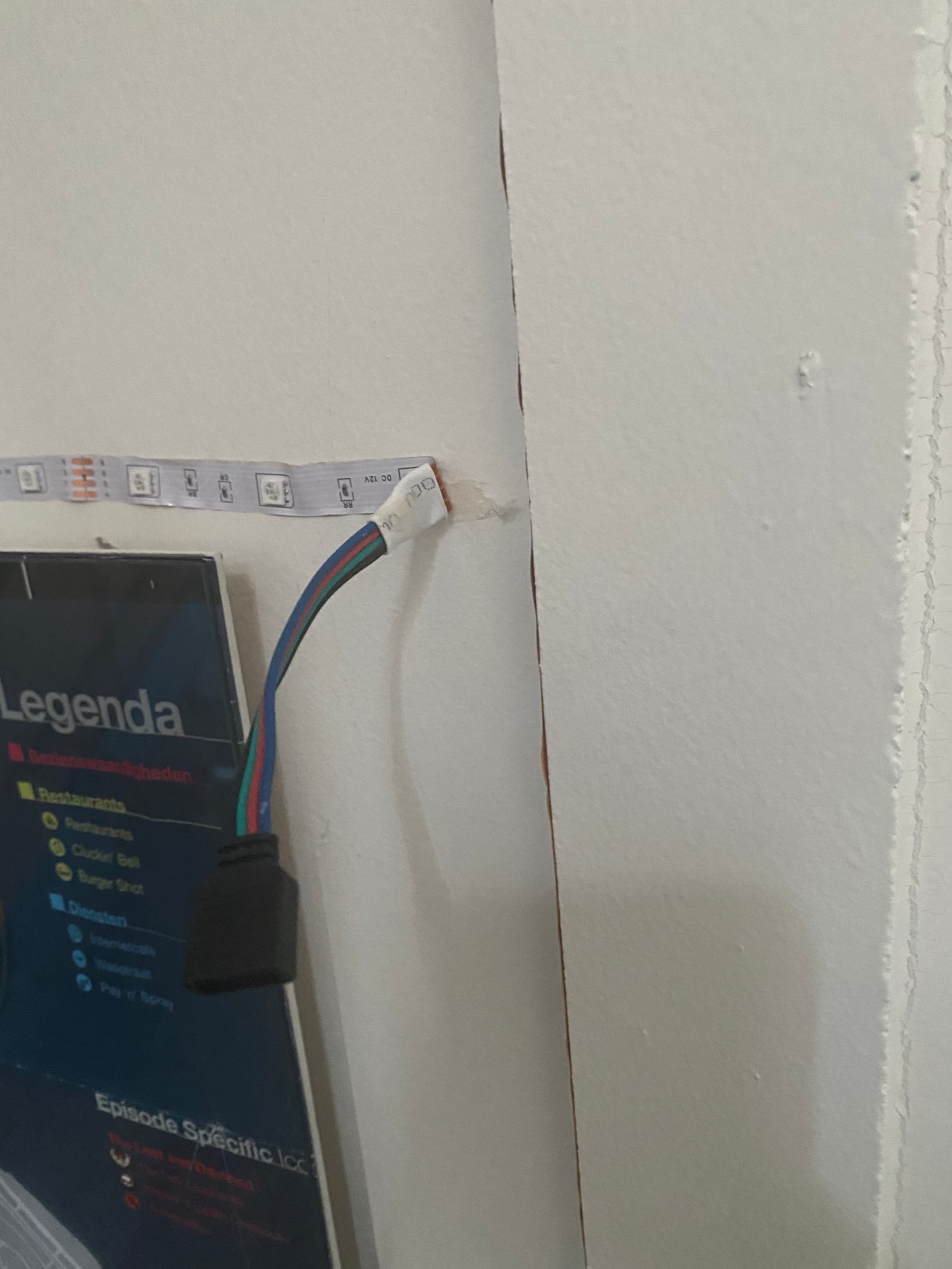

Maybe a off-topic question. But can I just cut the end of the ledstrip (see picture) off, without any problems for the ledstrip?
I mean the end piece, to extend the strip. Thank you!
@UA84 as far as i know: yes.
If your power supply is strorng enough to power the whole strip from one end. But I think it’s a SMD5050 right?
Thnx for your quick answer!
Yes, it is smd5050
I think you can. But i’m no expert :stuck_out_tongue:
It’s better to cut them off at the end of a circuit, most of the time you can see a dotted line printed (sometimes a solid line) on it, or it’s in the middle of the copper “stripes” (as seen on the left side of your picture, even looks like it has a black line there, thats the spot to cut it.
more info here
