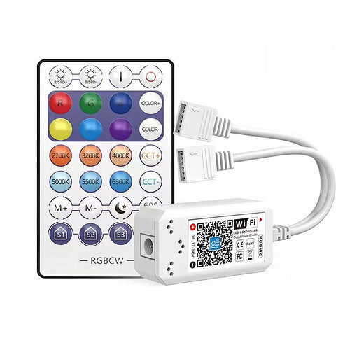

I have just received a RGB+CCT 6 pin wifi controller from AliExpress.
When I add it to Homey with the normal version of the App it says Type: Other and only can turn it on and off, other options don’t work.
When I install the test version of the app, it sees it as name: ak001-zj2146 and type: other. Again only of and off work.
Is this device supported?
