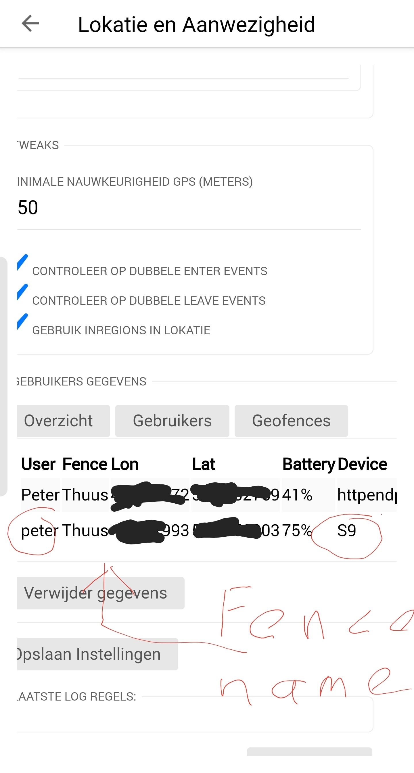

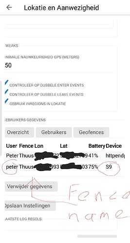

The password is the password for the user (Jeremy) that you created in the broker app
Peter S9 is the same login as used in MQTT broker.
So use the same user+password with both Owntracks and MQTT broker
S9 is just my description of my phone, and PD are my initials
On Jessica’s phone, u use again the same mentioned user+password (this authenticates Owntracks with MQTT broker) and instead of S9 u can use ‘Phone-Jess’ or just something you can recognize her phone with.

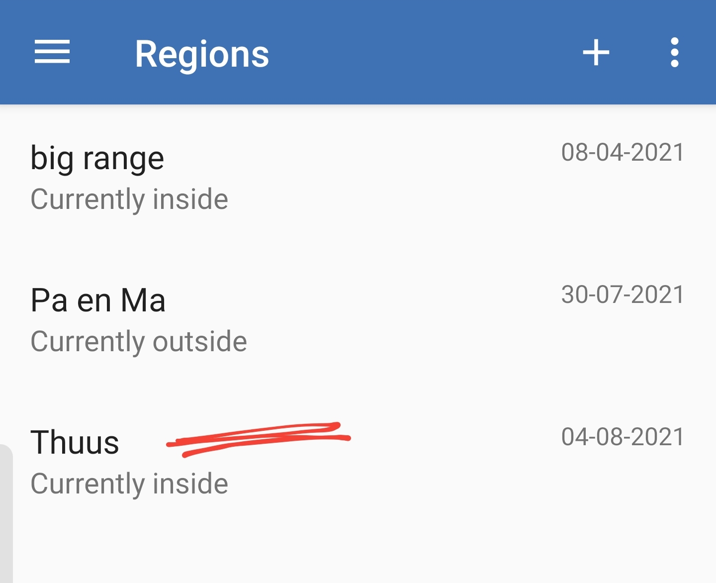

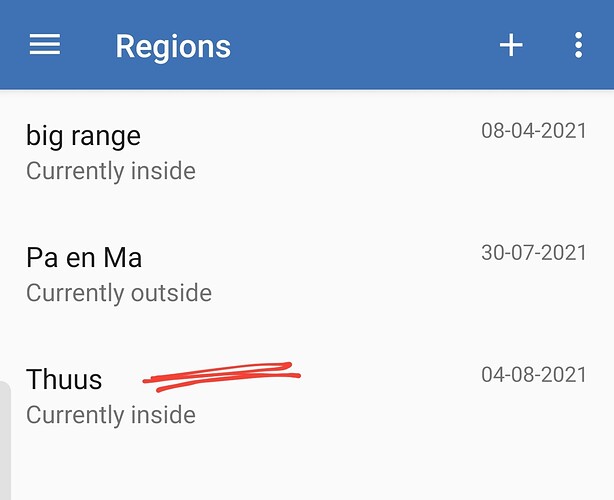

Fence names are also defined in Owntracks, but called ‘Regions’:

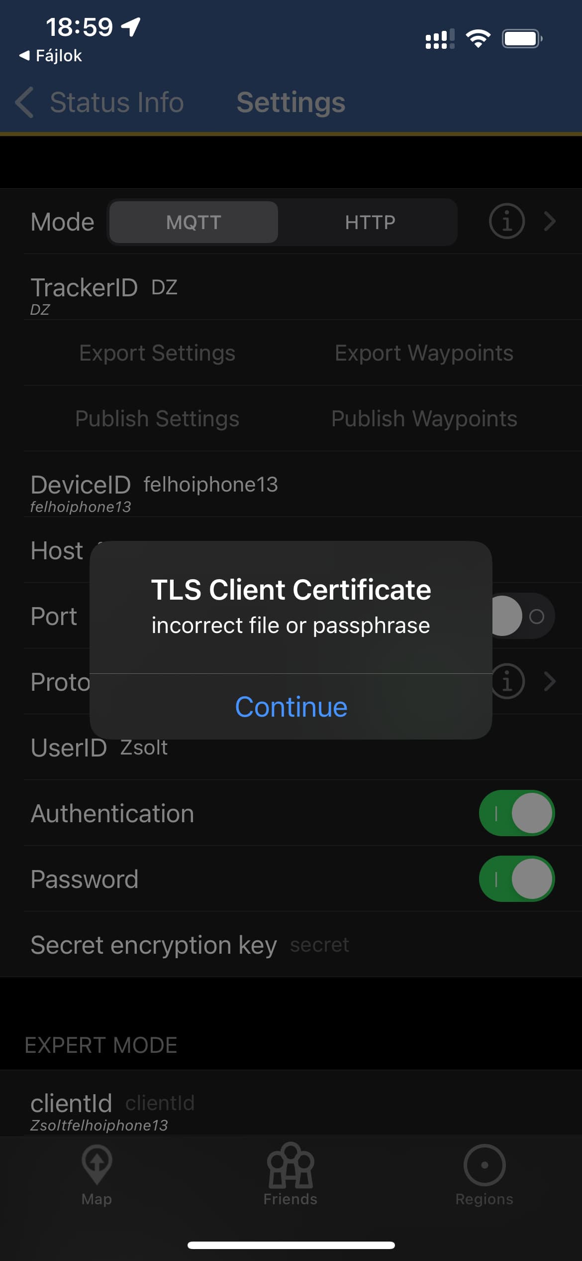

Here 3 pictures
and if I try install iOS device cerificate and after say this message:

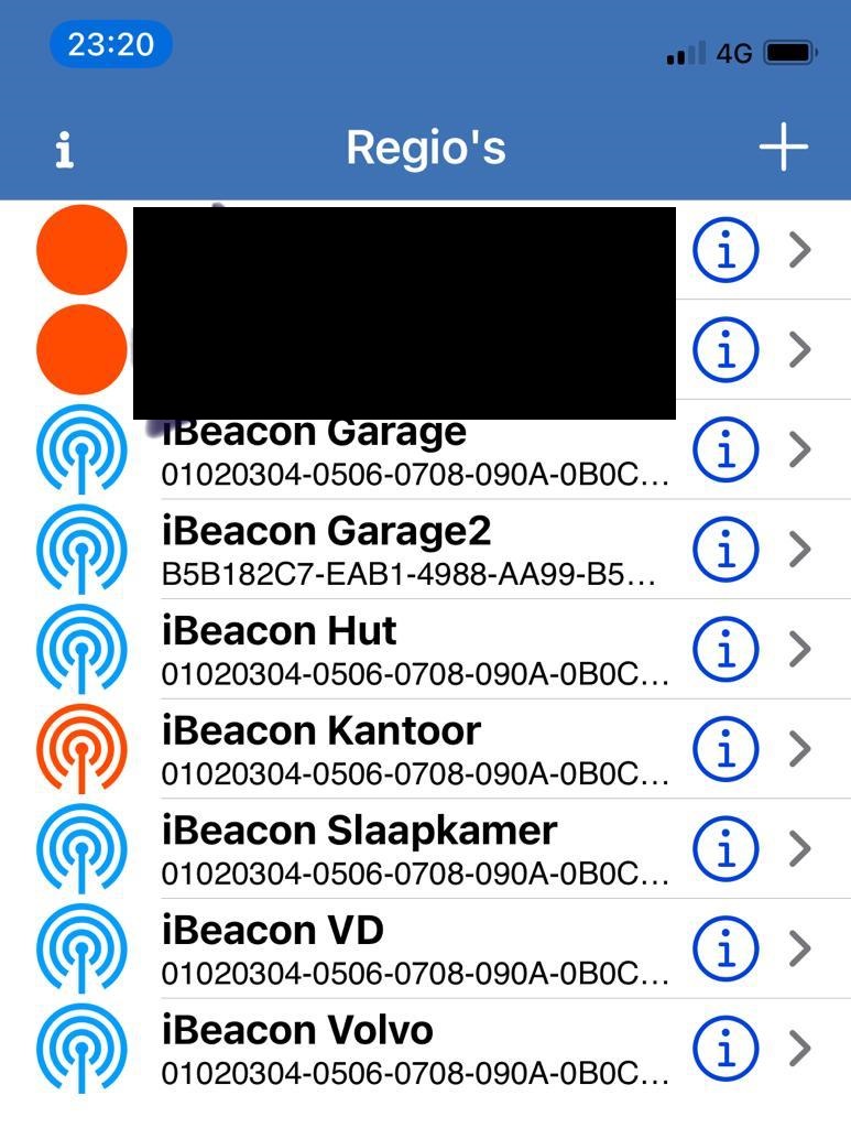

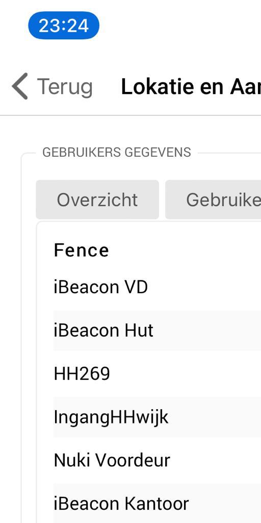

Aantal van de gemaakte fences en bluetooth beacons
Aantal van de fences / en bluetooth beacons (die hij ook als fence ziet)
