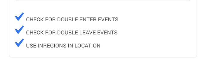

Please set these check boxes;
I had allready those checkboxes set.

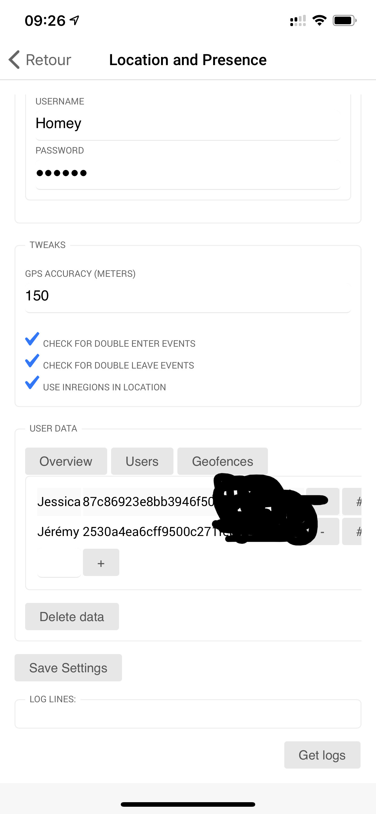

I’m trying to configure MQTT stuffon iPhone but not sure about the MQTT Broker config on Homey, Location app and Owntrack.
The Status is idle in owntrack so it found the broker i guess but where should i put the user value of location app ?

Idle is not connected. Check the broker logs to see if anything connects there and if so, configure the location and presence side of things to listen to the owntracks topic.
Also, the user stuff is set in the owntracks app on your phone and flows down to the location and presence app. Create the users and the fence in owntracks and try to publish them under settings.

I don’t know where to put the id of the user generated by location app.

And i don’t know where to put the “user id” generated in Location app.

I’m confuse, where should i put this users id ?
