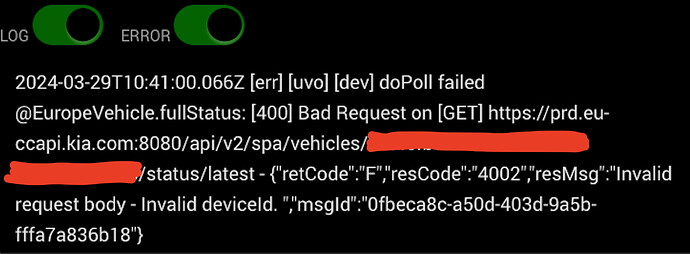

I’m trying to get things working with the Kia app, but I somehow seem to be running into something that I think should already been fixed (?)
When I perform an action (e.g. start AC) that works fine, but if I then start another action it fails (bad request, invalid request body- invalid device id). I read that that happens because the deviceid changes after every action, but wasn’t this already fixed?

@Gruijter How can i fix/work around this issue?
As mentioned I can do a single action (e.g. turn on the AC from a flow), however, If I then want to refresh the status in the app I am getting this error
Have you tried waiting a lot longer before doing the refresh? Like at leaat 15 minutes or so.
