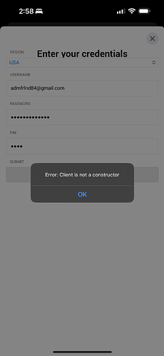

So I’m getting this when I try to add my credentials. :man_shrugging:t5:
Aw, yeah I think that is a bug when trying to add a car. Will look at it this afternoon.
v3.1.1 is ready:
  • Fix adding new device.
please test @TheAdrianMc

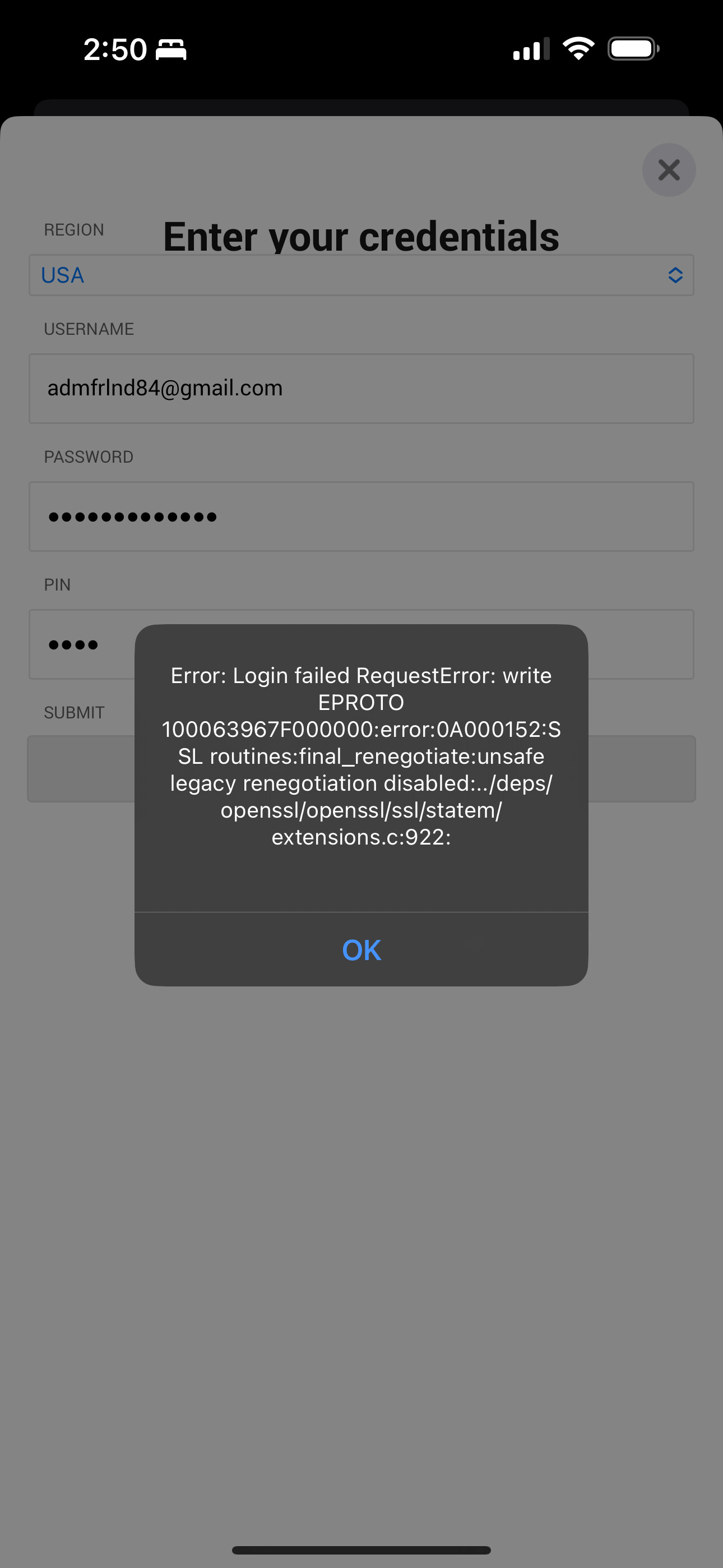

Now this. :man_shrugging:t5:
Yes, SSL issue is a known problem with US/CN servers, in combination with the NodeJS version used in HP2023. Apparently older Homey’s (using an older NodeJS version) do no thave the issue.
A new library package was just released this week. Will implement it in Homey when I have time for it. I hope it addresses the SSL issue.
Edit: nope. I tested it. The new package breaks compatibility with older Homey’s (HP2016/2019).
You just have to move to EU @TheAdrianMc

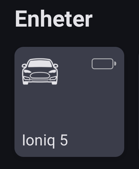

Hi and thanks for a great app!
In my iphone Homey app - Kia and Hyundai app, I cannot see the battery status from the Status Indicator anymore.
If changing to any other status indicator, e.g. Range → save, the indicator and value is presented on the device tile.
Is there a config change to be made, or is this a bug that needs to be corrected?
This is a bug in the Homey mobile app. Please report it with Athom.
