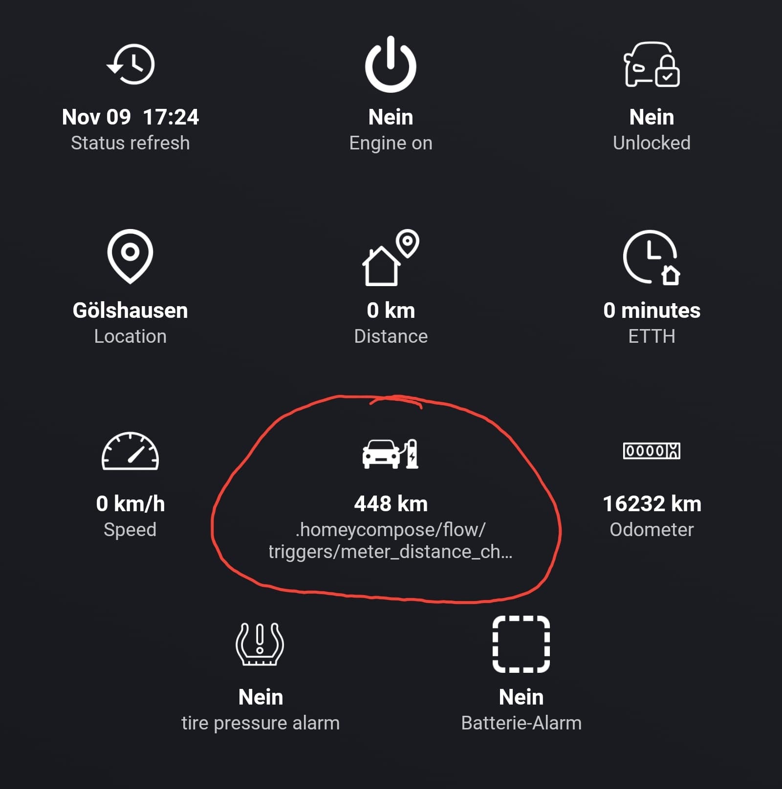

@Gruijter I experience this weird capability name too. It is on the flow cards as well as in the device details view like here:
It is supposed to say “Range” I guess.
Could you solve this bug? That would be great, because I have a lot of flows especially depending on the capability “range”.
This is a Hyundai ‘device’ by the way, not a Kia.
I think Kia or Hyundai doesn’t matter.
Thx 4 reporting. Will hopefully be able to check it this weekend.
New version 3.0.3 coming up: Kia and Hyundai App for Homey | Homey
  • Fixed range title.

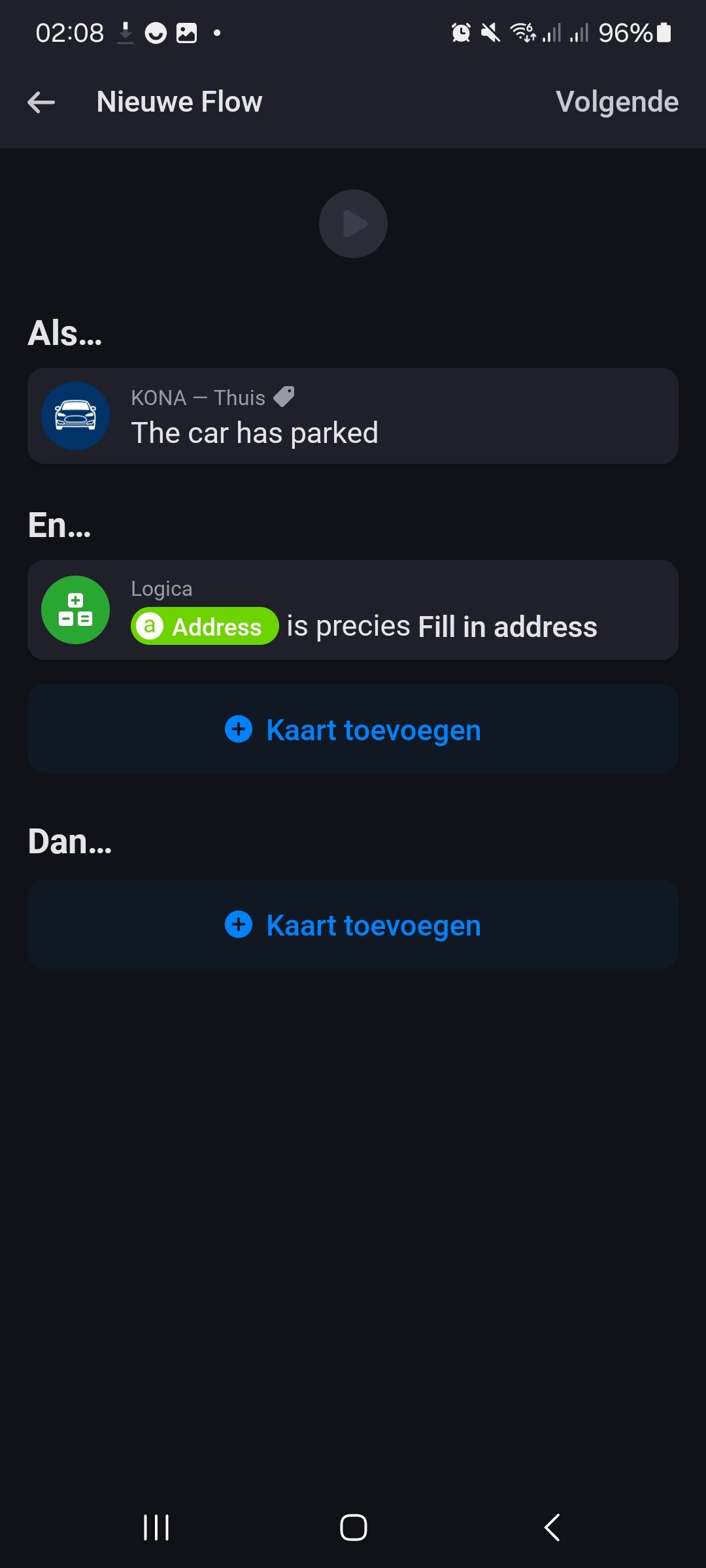

I’m trying to set up some flows based on park location but I don’t see that card although I can see that it is updated in the logs. Is there any way to use that attribute!
Tx!
Have you tried to use a variable via the logic cards?
When “the car has parked” (kona app card) if “location” is equal to … (logical card) then …
