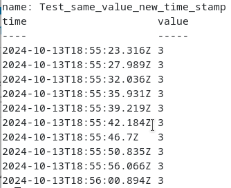

The last idea (“forcing” adding data with InfluxDb with a timed flow) unfortunately does not work. Tried this before ([APP][Pro] InfluxDb - #155 by fmb), but now again; it does not add data points with this specific data interval.
Do your conclusion come from Grafana, or have you checked the data in the database? If you did not know: You can not force values on the same device, you have to “create a new one” in the database. If I trigger my flow 10 times in a row, I get the same value in the database 10 times but with new time stamp.
Test flow with static value:
Result in the Influx database:
I am looking at the source table Grafana shows me. And I am using the same flowcard. What I need to do next is look in the database via de CLI. Need to find out how that works first, will let you know when I have had a look.
