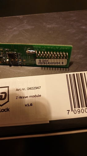

Z wave module fw 1.6 (in the manual says nothing about 01A like the fw 1.5 version)
Could the new z-wave module be the problem?

More people than me is having problems adding ID lock to their homey after upgrading to v3.1.0. Even those how added the lock under v.2 have problems now with the z-wave module 01A fw 1,5…
Also the new z-wave module whit fw 1,6 says 01B if it’s any different from 01A.

I do notice every report refers to v1.6 firmware of the ID lock; is this correct?
