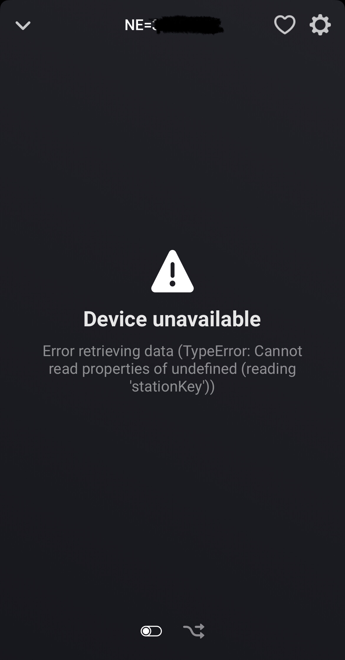

Since the new web option every time I add a device I get the following error:
Anyone knows how to solve this?
I try to connect via web with region03 to my system, returns no visible devices.
But, I connect with the other option - system after 2023. Unfortunately the data cannot be retrieving.
Device Unavailable
Error retrieving data (FetchError: request to https://undefined.fusionsolar.huawei.com:31942/thirdData/getDevRealKpi failed, reason: queryAaaa ENOTFOUND undefined.fusionsolar.huawei.com)

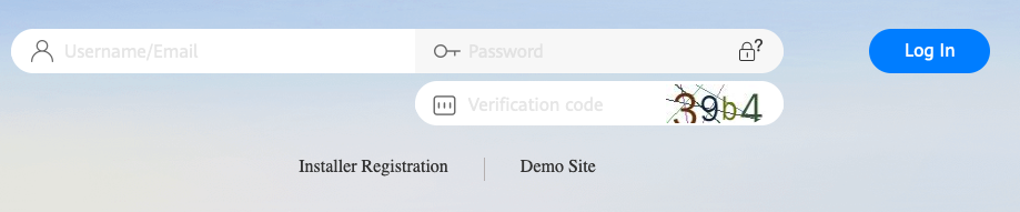

I noticed that on fusionsolar website they added a captcha? maybe that’s the issue now?
LE: this is the issue 100%. If you remove the device and try to add it again you get invalid credentials and no captcha.
Screenshot 2023-06-27 at 09.54.35
If the captcha appears, just login with it and the issue will be resolved
That’s the problem. There is no captcha in the Solar app login.
