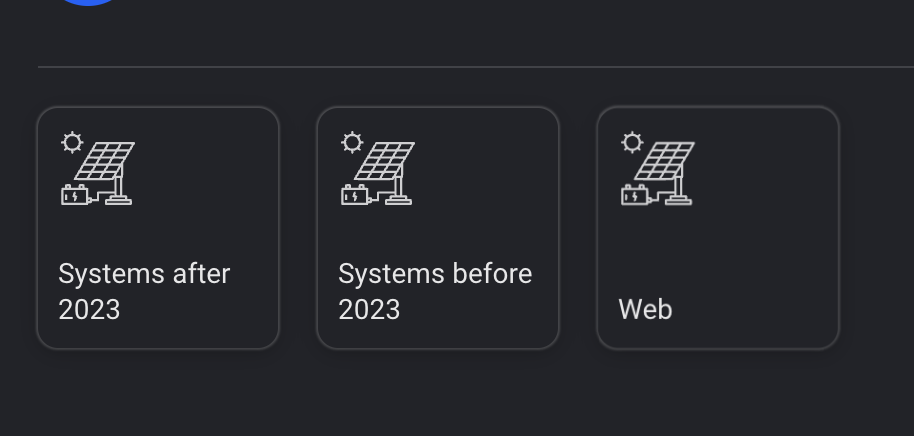

I’m getting an error message upon trying to add a Web device. I guessed it was appropriate to use the regular login credentials? The API credentials give an error message of incorrect credentials, where as the regular login gives this error message:
I removed the old device before adding the new one, just in case.
Correct, this new method has some bugs, but once these are fixed, the API part will go EOL.
The usage of the API is to unstable and I get to many support requests where Huawei is not able to help out
@jseverinson Can you check your region when you login into the website?
For now only region01eu5 is supported, I need to fix this.
Ah. Then this is the reason, I am positioned in region 2. Let me know when you’ve had time to add region selector and I’ll test again.

Hi wouter,
I juist installed the app on my Homey pro 2023. My attempt to Connect to my system via the web option returns no visible devices. I’m on the region 3 server so I assume this is the issue and need to have some patience until you get it up and running for all regions?
Thanks in advance for your support!
