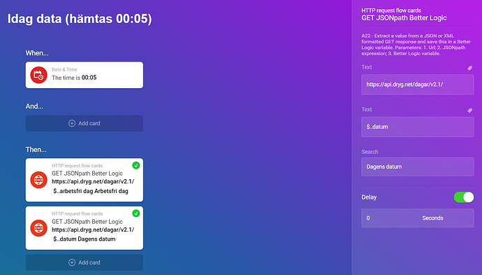

Something broke after 2.0.10 update yesterday. Flows have been working flawlessly for half a year, but not since yesterday.
I use GET JSON path better logic cards in different flows (example screenshot below). When testing the flow it executes with a green check mark, but the Better logic variable never updates. Any ideas what could be wrong?
The behaviour is exactly the same with other flows, but with different URL:s / API:s.
Any help is appreciated!
But looks more like a dot too many?
In .datum it says …datum.
Found my mistake with v .10. Will fix it right away and submit it to the app store.

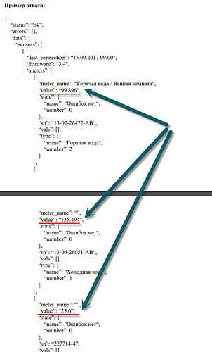

How to make flow in order to pass authorization (Content-Type = multipart / form-data). I am trying to get authorization by API https://www.saures.ru/upload/iblock/efd/SAURES-API-polzovatelskoe-v.3.12.pdf ?
Maybe I can not write off correctly from https://github.com/irritanterik/homey-http-request-actions#advanced-http-options
I want to get these values, shown in the picture
It’ll be quite a difficult process, because you first need to log in, extract the sid value, put that in a variable, and then use different flows that use the sid and make other requests. Perhaps it’s easier to implement using HomeyScript (but you need to know how to program JavaScript for that).
