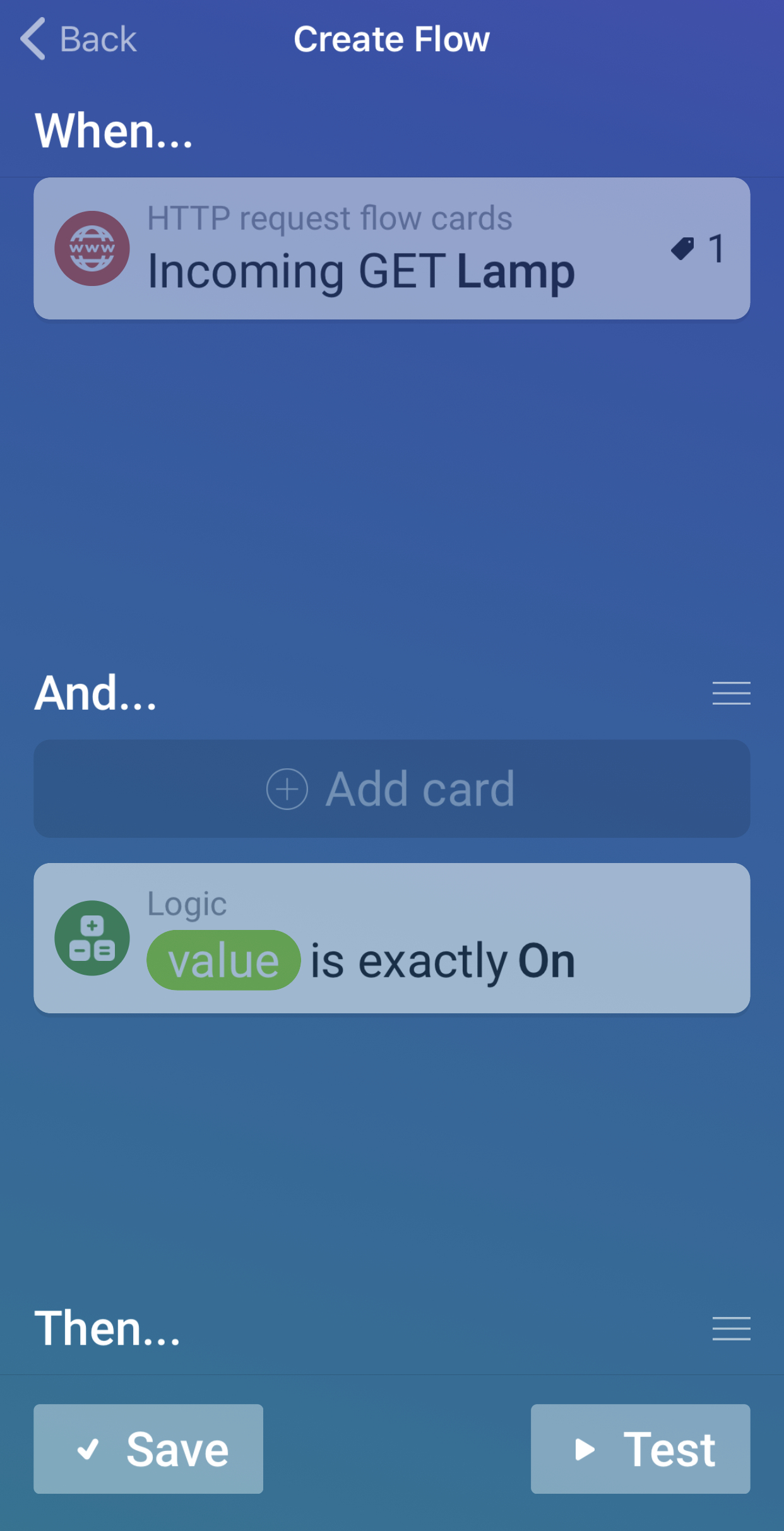

Assuming that I made a flow ‘X’ (Trigger is ‘This flow started’)
http:///api/app/com.internet/X
Responds “Ok” but flow is not executed
And u also made the flow to receive the GET request like this?
