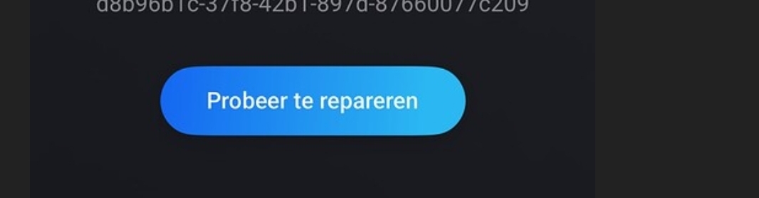

The first screenshot shows you selected the same Homey instead of the other Homey. That won’t ever work.
Because you don’t mention it: what was the result of pushing this “Repair” button?
In general, maybe a restart of the updated Homey solves it. Restarting after a firmware update solved the weirdest stuff.
Thanks for your reply. I’ve restarted both homeys, installed the same latest version of the app again, updated the other Homey as well, but same result. It did work flawlessly before and I have not changed anything but the firmware update of Homey1.
edit: repairing the device and selecting the other homey did the trick indeed. I think I selected Homey1 by mistake. Solved and thanks!!!
