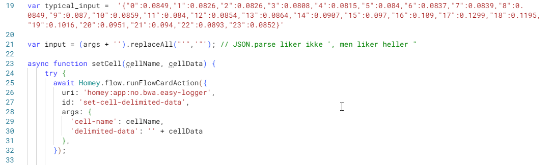

I’m not shure which script, but I guess there is a parse statement. Try to log the data before the parse. Looks like the input is not what you expect
Something like this:
console.log(‘input’, input);
const textFromJSON = JSON.parse(input1);
const t = Object.entries(textFromJSON);

Be aware that you cannot run this script directly without any input. You but aither create the flow or update script temporary to
from
const textFromJSON = JSON.parse(input);
to
const textFromJSON = JSON.parse(typical_input);
I testet with from
to
I’ve made a flow with update new prices and then homeyscript with price, but I get no prices in the sheet

Looking good, see no issues here
Do I have to wait for the new prices to be updated?
bwa
December 6, 2023, 10:34am
89
yes, it’s hard to test. But you can test by replacing #Priser with the example data from the script
Ok. Thanks. I’ll wait for the prices to be updated and then see
