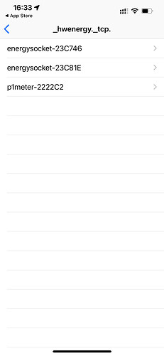

Also try this tool if you have a iphone/ipad:
and search for _hwenergy._tcp

So, where is your kwhmeter-xxxxx ?
As said one p1 and two energysockets.
But the kwhmeter is not in that list, so how do you expect me to find it?

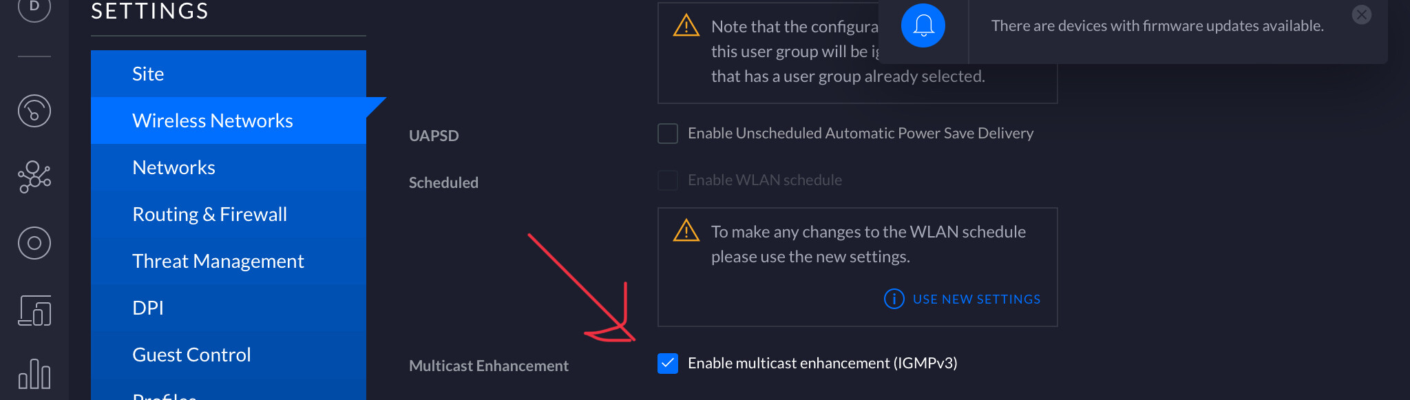

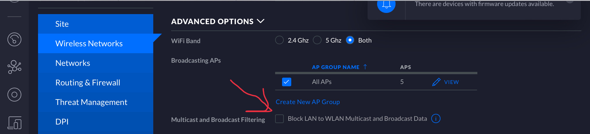

Untick this on your ssid network.
And be sure this is enabled:
